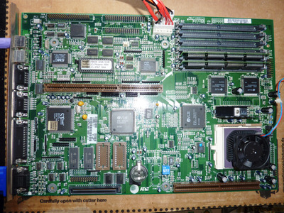

Since I´m collecting all kinds of mainboards made by FIC (until and including Socket 7) I stumbeled across this obscure LPX board.
It was OEMed for AT&T and their Globalyst 620 / 630 systems and came in different revisions / versions.
There´s a version with VIA chipset and a proprietary cache socket like they used on the 486-GAC-2 that looks like a VLB socket and there are (at least) two revisions of a second version with VLSI chipset and a standard CELP COAST socket.
I`m having "fun" with revision 4.11 at the moment which also has a special "feature connector" that looks like the 80-pin SCSI connectors.

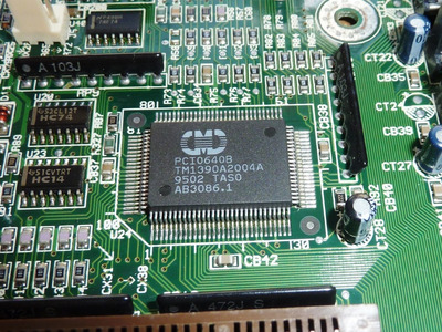

It´s also featuring the infamous "PCI0640B" IDE controller...

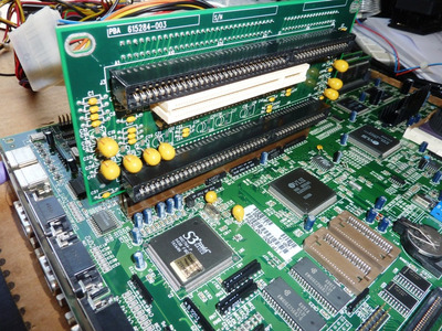

There´s also a nice riser card for ISA/PCI cards
285.89 KiB
1375 views

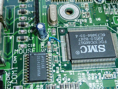

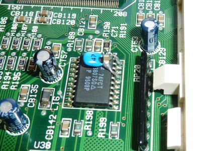

When I got this board it wouldn`t start due to some damaged traces near the CPU socket that were easy to repair with thin wires
218.03 KiB
1375 views

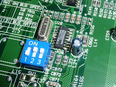

The board offers 50, 60 and 66 MHz FSB and multiplicators x2 and x1.5.
Jumper JP2 switches between core voltages 3.3V and 3.45V.

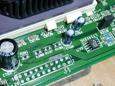

An additional VRM socket could also be soldered in to provide 2.8V for Pentium MMX but the BIOS doesn´t know any MMX models and given the multiplicator limitations I don´t thik it would make any sense.

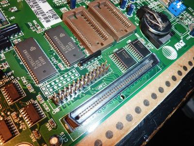

Here´s the VAFC "feature connector" that can be enabled in the BIOS menu, it´s not populated in later revisions of this board.
257.43 KiB

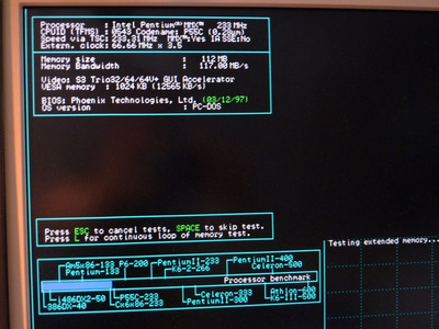

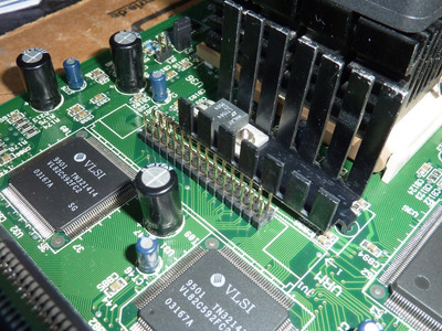

There´s some progress here. This board has a Socket 5 CPU socket, but is prepared for the connector for an additional 2.8V VRM. I suspected it´s in fact capable of split voltage AKA Socket 7.
So I fitted the 2x15 pins for the VRM in and cut the traces between pin pair 6 and 7, put one of my VRMs on top and a Pentium MMX 233MHz in the socket:
249.04 KiB
1323 views
259.76 KiB
1323 views

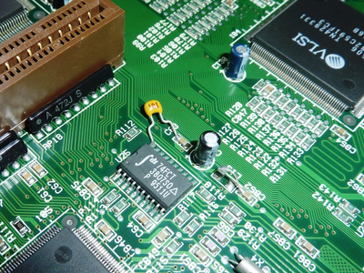

Then I set the multiplier dip-switch to x1.5 and started the system. To my disappointment the MMX was running at 133 MHz, it didn´t respond to the 1.5 multi by interpreting it as x3.5.
Checked BF1 -> open,
checked BF2 -> open,
checked BF0 (formerly BF) -> open.
On this mainboard the dip-switch releases BF0 from ground but there´s no pull-up resistor present to lift the BF0 pin up to Vcc. So I added a 4K7 resistor and voila
140.26 KiB
1323 views

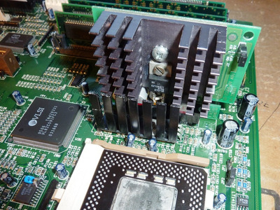

Then I managed to get hold of a working 256K cache-stick. It indeed has a proprietary and very rare pinout, but at least it´s a pipeline-burst type. (I doubt there exist 512KB ones).
1.63 MiB
1220 views
Now this board runs a Pentium MMX 233 at 233MHz with an additional 2.8V VRM and working L2 cache. It´s a really nice LPX board now that can be upgraded with sound and ethernet using the (also proprietary) riser-card.
