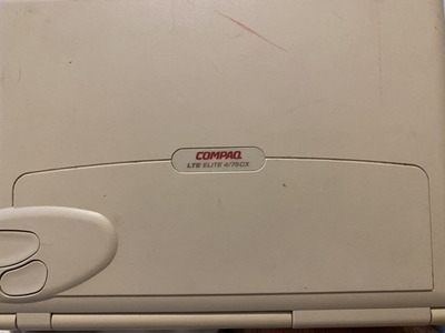

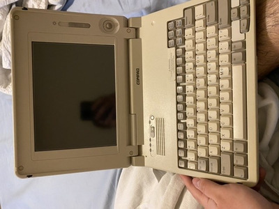

Hey everyone, I was told that posting here with my issue might be a good idea. I’m having trouble with this laptop I picked up. It boots up and seems to work well! But there’s no Os on it and the hard drive isn’t formatted. Is there a way to format a hard drive as bootable for Dos and copy over a pre setup freedos or Windows 3.1 system? Or even windows 95? I’m really at a loss as to what to do here. I have a 44 pin IDE adapter so I can plug the hard drive up to my windows 10 Pc. The hard drive scans perfectly and is in good shape and reads/writes at fullspeed. But I have no way to make a floppy disk for it and I doubt the floppy disk drive even works. Anyone have any suggestions? I’ve attached a pic of the laptop in question to this post if it helps

Yes thank you. The floppy drive is very broken in this. I think this is what I needed. I’m going to get the hard drive out this evening and give this a try. This didn’t come up at all when I was trying to google this exact topic so thank you so much!
Reply 4 of 11, by MoG91
Just to update anyone that cares. I plugged the disk into my computer using a cheap 44pin to USB adapter I have. I put the disk offline in disk part and made a virtual box image and installed dos as the instructions posted previously and it works! Now to get a network card and get some games on here. And to figure out why the mouse only sort of works. Thanks everyone!

Why are you so sure the floppy drive does not work? If you are going to keep this thing I strongly recommend you check if the floppy drive actually work, and if yes, then get some floppies and a USB floppy drive (as linked above)
Reply 6 of 11, by MoG91
vetz wrote on 2021-03-03, 22:58:
Nice progress
I tried it and it makes horrible noises and does nothing. I’m going to get it fixed when I have time and get some more floppies though. I have a laptop with a working floppy drive that I’ll write floppies from once I get it networked. For now I’m going to take the hard drive out of the device to load some games and files on there. I really appreciate the help and all the links.
Reply 7 of 11, by RoadWarriorB
Your floppy has a bad belt. Those Citizen W1D drives are notorious for broken belts. I've fixed about 7 myself.
Fortunately, they're found in a lot of other computers. Right off the top of my head, a few Sony Vaio external drives used them, as did a few Gateways. If it's just the belt, there's an eBay seller in Germany that makes the right size ones. Others may work too.
The drive has four external screws and two under the cover. Just make sure you use something to prop up the write head so you can more easily slide the top part of the cage off.
