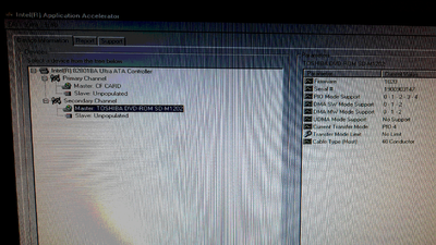

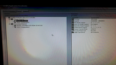

Oh also using the program I got some info here to show. I have no idea sadly what DMA SW mode is and if I really need it but is there such a thing as DMA supported optical drives? Drive is a Toshiba SD-M1202. On the bright side it shows that the CF card has it and through BIOS seems to be enabled. So I should be good on that end as the reason why device manager didn't show the DMA option as I think it's already enabled to my better understanding. Also I noticed that the optical is PIO and the CF card is UDMA, I do not know the difference between them. That was pretty much the rest of my question as I just saw the results from the Intel program and got curious. Thanks, pictures are posted below 😀
DMA SW = DMA single word
DMA MW = DMA multi word
UDMA = Ultra DMA
See https://en.wikipedia.org/wiki/Parallel_ATA#Sp … _transfer_modes
As for optical drives, DMA is typically supported and can be enabled when not automatically enabled (DMA being enabled is pretty much mandatory if you want to play a video DVD in DVD-ROM drive on a PC) .
You should be able to try to enable DMA mode for your optical drive using the Intel Application accelerator application .
