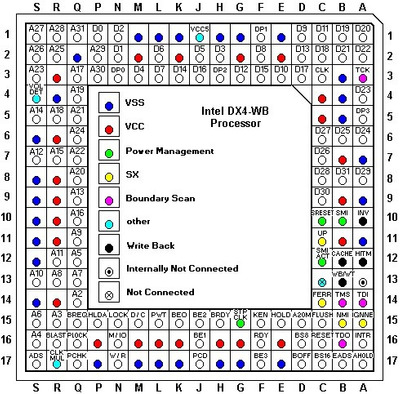

Not sure about M919 , but many S3 boards sometimes support power detection sense with DX4 cpus. Thus if you put a 3.3V CPU with low signal on VOLTDET pin (Intel DX4, AMD DX2/DX4, Cyrix 5x86, ...) they automatically switch to 3.3/3.45V irrespectively if you have your jumpers set to 5V.
The only way is to check the voltage by multimeter.

Reply 7 of 25, by mpe
If you mean the voltage then you can measure between any VSS and VCC pin (highlighted blue and red below) on the picture below. This is the pinout as you see in the socket.

Reply 8 of 25, by SScorpio
mpe wrote on 2021-03-15, 14:49:
S4 on the pinout is the VOLTDET pin. I believe it needs to be grounded by connecting it to one of the VSS pins for the voltage drop to occur.
