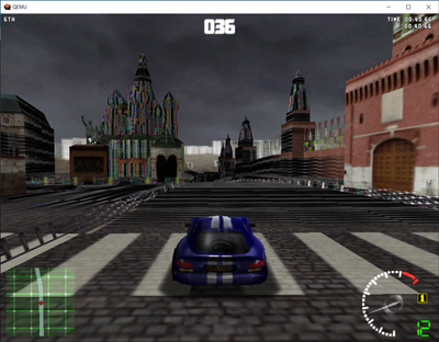

But now the game shows the same "rainbow" discoloring for distant texture mapping, similar to Ultim@te Race Pro that I reported earlier. Check the screenshot below, on the race ground and distant iconic Moscow building.

Reply 3 of 32, by Dege
I'm not sure if you're on windows, but what if you run it natively? You can copy dgVoodoo's ddraw.dll and d3dimm.dll for the menu part of the game.
Reply 4 of 32, by kjliew
Yes, I am on Windows 10.

Reply 6 of 32, by kjliew
OK, the game ran fine on native with WIN32 version of Glide3x DLL.
The game also worked fine with nGlide 64-bit Glide3x DLL on QEMU. so I doubted if the ball was on QEMU Glide passthrough.
DOSBox SVN does not have Glide3x passthrough, so I can't check over there, but Ultim@te Race Pro showed exactly the same "rainbow" discoloring for distant texture mapping with WIN64 version of Glide2x from either DOSBox SVN or QEMU.
Let me know how you would like to proceed on this, if you wish to troubleshoot on QEMU x64.

Reply 9 of 32, by kjliew
I tried dgVoodoo2 WIN32 Glide3x with QEMU x32 and it was the same. So that likely ruled out any 64-bit pointers discrepancies.
Since the "rainbow" discoloration slowly faded and turn into good rendering, perhaps there is something to do with how MIPMAP works in the dgVoodoo2, if you had dependencies for the shader language on addressing. Otherwise, the corruption would have been persistent regardless of distance from viewpoint. This is what I can think of why it worked native but not from DOSBox and QEMU as the data marshalling during pass-through is likely reusing the same address over and over again.
Let me know if I should check out other older versions of dgVoodoo2, if you could recall the changes in MIPMAP implementation.

Reply 11 of 32, by Dege
Oh, so it's not 64 bit.
Yes, the problem is inevitably about mipmapping. The first mipmaplevel is good but all the others are trash. That's why it turns into good when looked from a close viewpoint.
But, I checked out the Glide log for this game and the only texture upload call is grTexDownloadMipmap. It has only one pointer parameter, the mipmap data.
dgVoodoo doesn't store that pointer internally, the bitmap data is copied to the texture memory before returning from the call, so the pointer itself can't be the problem.
(I didn't change the mipmapping implementation across versions.)
It's strange. Are you sure you provide (copy) the right amount of bytes when marshalling the bitmap data from the application to the wrapper?
Like, calculating the required size from the LOD parameters can be tricky because those are numerically different between Glide 2 and 3. Or sg like that.
Reply 12 of 32, by kjliew
Well, the Host Glide3x wrapper 😉 tells the size of MIPMAP to the guest stub (grTexTextureMemRequired()) and the guest stub will push the MIPMAP into FIFO. Upon FIFO flush, QEMU reconstructs the GrTexInfo pointer and sends to Host Glide3x wrapper. You should be able to check the size of MIPMAP dgVoodoo2 returned with grTexTextureMemRequired() prior to each grTexDownloadMipMap() call.
