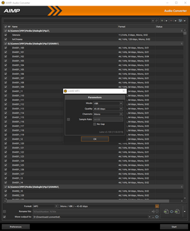

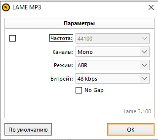

6. If you have a problem with the speech/dialougue/audio in game, meaning it will cut out after the beginning of longer sentences (audio stops playing), then overwrite the MP3-files located in the game folder under "..Media\Dialoghi\Mp3" with the fixed ones. (I converted these with variable bitrate and it somehow fixed the problem for me. Not sure why it works, i played around with several conversion settings and found a working method by trial and error.)

4. For fixing the audio you have to convert the MP3s with the settings shown in the attached image and then replace the original ones. Make a backup first, in case it doesnt work. I used AIMP with the included AudioConverter: https://www.aimp.ru/?do=features
