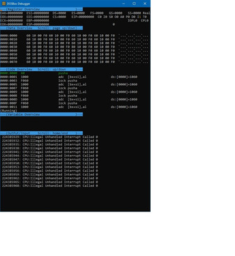

Reply 4 of 6, by Agathosdaimon
okay i did the debug dosbox and attached is the readout i get - illegal unhandled exception errors just scrolling very fast - what does this mean?
134.92 KiB
870 views
Reply 5 of 6, by Rwolf
That looks wierd...it's been long since I looked at assembler code now, but you have a stack overflow, and there are no segments setup yet, all are zero.
This game was for 8086 I read, the next version FalconAT for 80286, but lowest DOSbox machine type is 386 I think? Maybe some quirky 8086 init code failed?
Reply 6 of 6, by Agathosdaimon
thanks for the reply - yes i pmed with another user who looked at it and it seems that my falcon disk is just garbage, a shame - now i have two boxes of Falcon both of which have non-working disks, i have just come to accept that its best just to put the game on a cdr and stcik that in the box as the floppies just arent reliable and too costly to keep buying old boxes of the game as much as i love it
