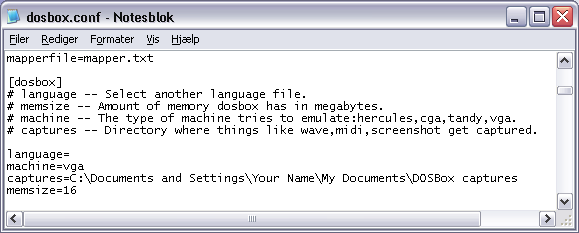

By default, DOSBox puts all its captures in a directory called ..... (big surprise) .... 'captures' (you can change the name by editing the file dosbox.conf). But the directory have to exists - DOSBox will not create it for you.
One thing that might confuse you (an DOSBox) is where this 'capture' directory is supposed to be created. My suggestion is to use an absolute path, like
captures=C:\Documents and Settings\Your Name\My Documents\DOSBox captures
Edit: Fixed spelling error and updated the attachment.

Reply 3 of 13, by MiniMax
Rank Moderator
Moderator
😊 Oops!! 😊
I should have tried my own advice before posting it. Seems like DOSBox does not like the double quotes (") when specifying the name of the capture directory 😵
Try it again, this time without the quotes:

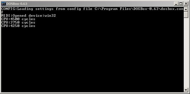

Reply 7 of 13, by Zanthia84
hi again. i'm using dosbox version 0.63. and in my dosbox status window there doesn't read anything like Capturing Wave Output to capture\iw_000wav and i didn't get any error message when i used the double quotes. what version are you running MiniMax? thanks for your quick replies and help. i added my status window as an attachment.

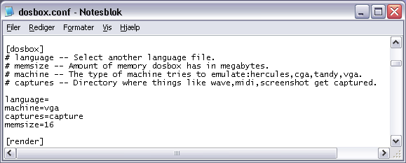

Hmm.... I think it is time for a little bit of sanity check. First I want to make sure that you are editing the same config file that DOSBox uses. From the screen dump I can see that the file is C:\Programs Files\DOSBox-0.63\dosbox.conf. Is that the file you are editing?
Do this please:
  1. Create a directory on C: called C:\Captures.
  2. Put that in the captures line:
    [dosbox]
    captures=C:\Captures
  3. Also, in the CPU section, set the no. of cycles to 4000:
    [cpu]
    cycles=4000
  4. Start DOSBox. Check the title of the main DOSBox window. What does it say for Cycles? 3000 or 4000?
  5. What happens if you press CTRL-F11 a couple of times, and then CTRL-F12?
    Do you see the number of cycles changing?
  6. Start you game, and when the sound starts, press CTRL-F6.
    Anything in the status window about Capturing Wave Output to C:\Captures\name-of-game_000wav?

Reply 9 of 13, by Zanthia84
hi again MiniMax. yes, i'm editing C:\Program Files\DOSBox-0.63\dosbox.conf. i created Captures directory in C: and i set cycles to 4000. i started dosbox and in main window it says cycles 4000. when i press CTRL+F11 the cycles lowers and when i press CTRL+F12 the cycles gets higher. yes, i see cycles number changing. i started my game (rise of the dragon) and when sound started i pressed CTRL+F6. nothing is displayed about capturing wave output to anything. thanks for trying to help. i added my new status window as attachment.

Reply 10 of 13, by MiniMax
Rank Moderator
Moderator
Okay - I am lost for ideas. You are editing the right config file since the 4000 cycles show up, and yout CTRL-Fn keys are working too...
