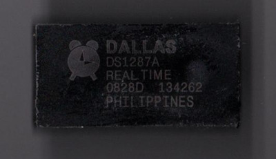

Anyhow, I thought a new Dallas DS1287A chip would help me out, so I bought one on eBay.
I remember that when I removed the original RTC, I bent some of its pins in the process. I supposed no harm was done, as I thought of that RTC as dead anyway. However, when I later turned the system on (without an RTC installed), it wouldn’t POST. No sound, no image, nothing. Is that normal, expected behavior for a system without an RTC?

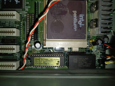

I had been thinking for some time about finally getting the system to work again. So I got it out today, opened it up and removed several internal devices. Two of those were serial ports which were present when I bought the system and one was a PCI USB card I installed in 2016.
I then inserted the Dallas DS1287A into the socket where the original RTC used to be. I connected the system to a wall outlet, and turned it on. It still won’t POST with this new RTC installed.
Do you think I broke something else when I pulled out the original RTC in 2016? Like inside the RTC socket?
Did I do something wrong when I inserted the “new” RTC (bought in 2016) today?
Is there another likely reason that prevents the system from POSTing? Should I pull out the RAM modules?
The original heatsink and air cooler were glued onto the CPU. I pulled both off in 2016 and then installed a heatsink and air cooler that came with a Spectra 400 CPU upgrade I bought before that time and which worked for a while in another system I used to own.
After the DS1287A didn't get the system to POST today, I removed the Pentium 1 CPU from its socket and replaced it with the Spectra 400. I hoped that would get the system to POST, but, unfortunately, it still doesn’t. I later inserted the Pentium CPU again together with the Spectra's heatsink and cooler.
Image 1
The DS1287A I inserted today.

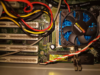

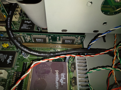

Image 2
What is the card that says "tmTECH T32M3232A-70"?
It's a COAST : Cache On A STick module
also, if you still have the old RTC, you might consider modding it... and fixing the bent/broken pins... ymmv.
Reply 2 of 32, by Deksor
The RTC you've put looks faked to me. If you rub a Q-tip with some alcohol on it I'm sure you'll start to see the q-tip turn dark and the writings will disappear.
Would you like to take a good photo for our database here please ? http://www.win3x.org/uh19/motherboard/show/1223 (the one on the other thread has a pretty bad looking glare).
Do you still have the original RTC ? Maybe you could try to put it back in there.
Most boards do POST with a RTC with a dead battery in them, only you won't be able to boot off of anything. And most don't when there's no RTC installed, meaning there's something wrong with the RTC (either the fact the RTC is dead or the mod involved).

The CMOS memory is inside this kind of RTC.
You can hack this kind of RTC to have a external battery instead. It's a bit ugly but it works great
Something you could try would be to use a POST card to troubleshoot the computer and see at which step it hangs

FYI, most of the time the pins that have the battery attached are actually bent upwards, so they're not broken off... Unless there's more than 2 missing.
RTC, 'cmos memory' and battery are included in the black box labeled bq3287.... or DS1287..
Reply 7 of 32, by Odiseo
Deksor wrote on 2021-05-15, 20:59:

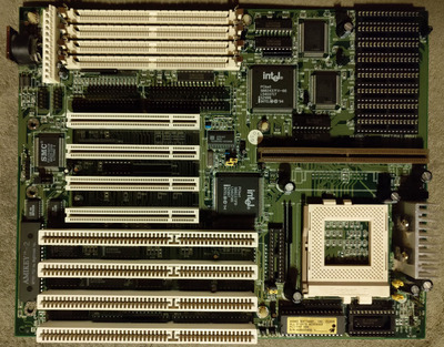

Reply 13 of 32, by Odiseo
Dallas DS1287A.jpg: The RTC I bought in 2016. I took the picture after rubbing the top of the chip with some tissue paper with some cleaning alcohol sprayed onto it.
See attachment for pictures of the motherboard. Are these pictures good?

Reply 14 of 32, by Deksor
As a replacement you can get the DS12887+ iirc.
The photos are great, thank you 😀
alternative
Reply 16 of 32, by Deksor
yeah, but it's the only modern replacement you can find. Otherwise you need to make your own solution (modding the old chip, making your own battery-chip, etc).

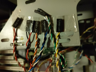

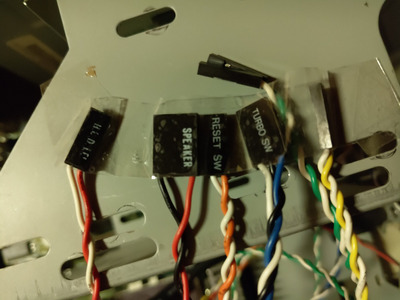

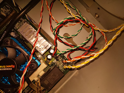

I put the motherboard back inside the case. I'm about to connect the FP Header cables the way they used to be on the board.
There is one cable (Turbo Switch, the blue/black/white cable) which I don't know which pins it should be connected to.

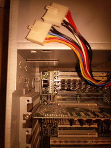

Reply 18 of 32, by Odiseo
I forgot to take note how these 2 6-pin ATX cables were connected. Which cable goes on the top connector? And which one on the other?
EDIT. According to what I read during some research, the black wires should be in the center. Is that correct?
