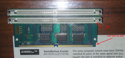

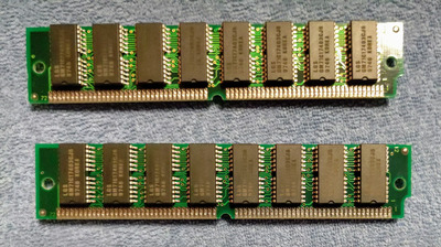

Reply 6 of 42, by Ydee
The 72-pin simm module has a cut-out on one side. The module slot has a locking key on the same side to prevent the module from being installed incorrectly. It may be possible to install the module in reverse, but certainly not easily and without the use of light violence. Maybe you really didn't have the modules inserted fully (holes need to land on the pins and lock the sides to snap).

Reply 7 of 42, by Odiseo
Ydee wrote on 2021-06-07, 13:45:
But what if I inserted 1 or both modules "loosely/halfway" backwards? I'm thinking that may have been what happened. Would the board still have fried (or otherwise killed) itself with a backwards (though not fully inserted) module?

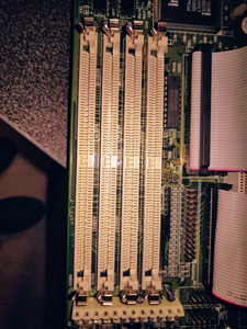

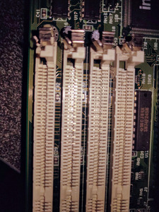

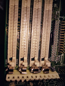

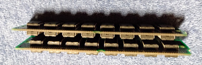

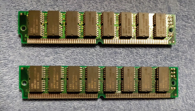

Reply 9 of 42, by Odiseo
I made pictures of both the RAM sockets and the modules.
I inserted the modules into the two slots closest to the IDE interface yesterday. I just checked the board's schematics and those slots are Bank 1.

Reply 10 of 42, by Odiseo
Here are the RAM slots.
Reply 11 of 42, by Odiseo
I removed all the components again, including the RTC.
I cleaned the contacts of the RAM modules witth alcohol. I then reseated all the components on the board.
This time I put the RAM modules in Bank 0, with the cut-out where the notch is in the slots, to the side next to the two power connectors for the cables with the black wires in the middle.
I turned on the system and it still produced long continuous beeps.
I'm guessing I really did insert the RAM modules backwards (into Bank 1) yesterday. Like I said, I didn't apply a lot of force, but maybe they were in far enough to cause the board to die when I pressed the power button? Is thatpossible?
appiah4 wrote on 2021-06-07, 10:28:
Take up close and clear photos of the sockets please.
What do you think, based on the pictures I posted?
Reply 12 of 42, by appiah4

Odiseo wrote on 2021-06-07, 18:09:
I can't see physical damage.
Just to be sure we are on the same page, when I say Bank 0 I mean the two slots marked SIMM1 and SIMM2, the two at the top edge of the board. Fill only those two, with identical ram sticks.

Reply 15 of 42, by Odiseo
snufkin wrote on 2021-06-07, 20:57:
Is there something between the slots 3 & 4, near the top?
I think you're right. I see something too. I'll take the board out of the case again tomorrow to have a closer look.

Reply 16 of 42, by snufkin
Odiseo wrote on 2021-06-07, 21:52:
Assuming that I *probably did* insert the modules backwards (albeit loosely) into Bank 1 yesterday without physical damage having resulted from this on the modules nor the slots, Is there still hope for this board? Is there anything else I can do to get it to boot?
No idea really. If that's happened (and it does seem unlikely without ending up breaking either the simm or the slot) then having +5 applied to non-power pins may have damaged the module (some chips have the max voltage on an input pin as Vdd+a tiny bit, so applying 5V to an input is bad if the actual 5V supply isn't connected).

So, the RAS2 signal from the motherboard may have been shorted to ground, could damage the chipset output driver? +5V was applied directly to D14, A2 and CAS1 on the modules, with no +5v applied to the module Vdd, could have damaged the module. CAS1, D14 and A2 from the motherboard were probably all shorted together through the 5V connection on the module, could have caused problems for the chipset.
A lot of uncertainty there though. I'd get the board out, check out if there is anything between the slots (it looks to me like it might be a solder splash, but no idea where that'd come from), and check if any of the solder joints between slot and motherboard were damaged if there was a lot of force put on the slot.
