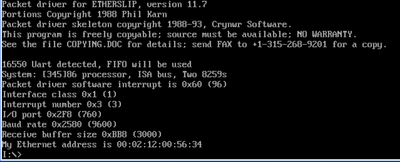

And client reports:
48.3 KiB
865 views
screenshot

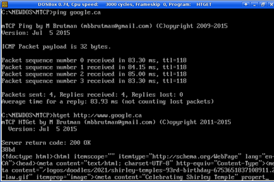

But when I try to use the internet (with mTCP's HTGET) in DOSBOX, ping works fine but trying to download a webpage takes forever at best. Here's another screenshot:
78.79 KiB
865 views
screenshot of dos internet
So it takes 1 second to load the first part (what you see), then about 30 seconds for the rest of the content to appear, then another 20 seconds to supposedly close the connection. then I get:
"NULL assignment detected"
and the program closes.
Why would the internet take so long in DOSBOX?

Reply 1 of 4, by mbbrutman
That mTCP is 6 years old already. The newest version was released in March 2020, and there were significant fixes to htget.
On your speed problem ... I'm not sure how DOSBox models the serial port, but if it is actually doing it in a timing accurate manner then 9600 bps is going to be pretty slow. That works out to about 1 character per millisecond. The ping packets take about 60 bytes, so 60ms will be the lower bound for those. With MTU at 576 each packet is going to take half a second to transmit or receive. Even without the TCP/IP overhead you are limited to no more than 1KB/sec for transfers.
If DOSBox is not modeling the speed of the serial port then it is not an issue. But you should try moving to a faster speed, such as 115,200 if you are using virtual hardware. If that improves things then we will know if DOSBox was modeling the speed of the serial port accurately.
Reply 2 of 4, by mike_canada
mbbrutman wrote on 2021-06-09, 21:26:
Ok so I tried the newer HTGET with same setup and this time I had to wait about 10 seconds for any output, then half the data appeared all at once, then I had to wait another 10 seconds, and I receive the rest of the data along with "null assignment detected".
But it seems that the speed setting helped but I don't know why the dosbox manuals for networking only advocated for 9600bps.
