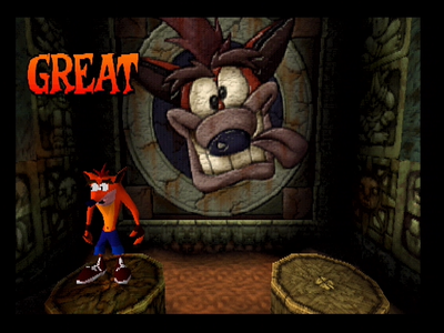

Reply 7 of 7, by anakin94
Today i got them.
Both are working fine under Windows XP and Windows 7 64 Bit.
Sadly they have the same problems.
But i found a solution for this ghosting issue.
The solution is to set the Yadif Deinterlacing filter at capturing.
Before, i tried to deinterlace the video after capturing.
That takes me of the opportunity to record with DScaler, but VirtualDub working also fine.
I still doesn't understand why it not working properly after capturing.
I tested many filters and programs and all results were the same, or did i'm something wrong?
But glad im happy to have a solution.
The Miro Video PCTV has a nice picture quality:
    502.88 KiB
    42 views
    Miro Video PCTV S-Video - Crash Bandicoot (Demo One V4)
