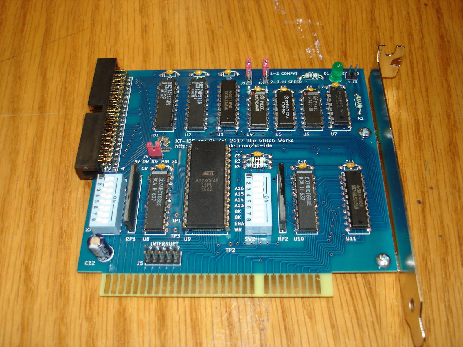

I thought he meant using something like this: https://www.glitchwrks.com/images/xtide/xt_id … /rev4_front.jpg
So I leave the SATA drive connected to the motherboard's IDE port (via adapter) then plug the XTIDE BIOS into an ISA ethernet card and voila, DOS sees the full 250 GB and everything works just fine?

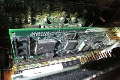

The only DIP-28 EEPROMs I have in my bitnare 32 Kbyte, which are supported XTIDE BIOS. I grabbed ide_386l.bin from their website and programmed a Winbond W27E257-12 EEPROM in an external programmer. I plugged the EEPROM into the DIP-28 socket on the Intel EtherExpress Pro100 ISA LAN adapter card. There was no notch on the DIP socket to indicate orientation, so I looked for GND and VCC on the socket using a DMM. Pins 14 and 15 measure to be GND, however the datasheet shows Pin14 as GND and Pin 15 as Q3, which is a data input/output. Hmm... Also, Pin 28, which is supposed to be Vcc, has only 28 ohms of resistance before heading to the 5V rail. Hmm...
179.86 KiB
1193 views
Nonetheless, I turned the computer on. Screens stayed blank. I put my finger on the EEPROM and my skin was burned. There's a small welt on my finger now (24 hours after the burn). It was VERY hot, as if I put my finger on my wood stove's glass door. I turned the system off and removed the EEPROM. System still works.
Were there non-standard pinouts on these Intel/IBM ethernet adapters? Or did I need to have blanked the EEPROM before I could turn on the system?
According to the XTIDE website, I am supposed to program the EEPROM while in the computer, but I didn't think I'd get a short if I didn't.

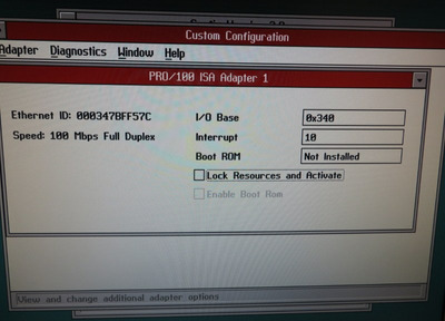

I am reluctant to try it again with the EEPROM blanked. Should I? Also, it doesn't appear as if the boot ROM can be enabled by force. The DOS setup utility needs to detect the presence of a boot ROM before the option gets un-greyed. See here:

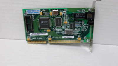

This image seems to indicate the notch/cutout is closest to the ISA connector:
189.54 KiB
1180 views
No physical cutout on the DIP socket, but the chip alignment 'notch' is present on the silk screen printed below the socket.

Also, yes, you can just buy a ROM hosting card, if that's what you want to do:
https://www.lo-tech.co.uk/product/isa-rom-board-pcb/
It can host the XTIDE BIOS, or any other 32/64KByte ROM extension that you want to use.
(no affiliation and I've never used one myself)
