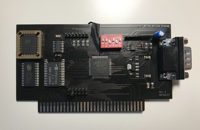

This is revision 2. Almost complete. The final revision will be smaller.

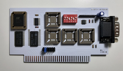

This is the first revision. At first the plan was to use the AMD PLDs, but I quickly got off of that.
They are super sensitive, not readily available, and inconvenient to program. Simply unsuitable for a quick trial and error.

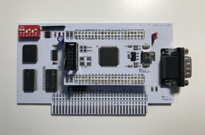

This is the development board. My Altera CPLD development board is on it. So I can quickly use it in other projects in the future.

Please improve the edge connector. Ensure it is properly beveled and rounded, pull back the solder mask from it, and at a minimum use ENIG (hard gold would be 1000x better)
Reply 7 of 10, by JimWest
Many Thanks!
Yes, of course there are also software solutions. I can't say exactly where the difference is.
But I just like the hardware approach with a controller on my desk, a blinking LED and a button that I can press whenever I want. 😆
maxtherabbit wrote on 2021-06-12, 02:48:
Thanks for the comment. The final revision will definitly be at least ENIG.
What exactly do you mean by properly beveled and rounded?
And why pull back the solder mask from it?
It is a simple D-SUB male connector with 9 pins. Identical to the original. It is in the same position as a VGA connector. So you can also use the slot bracket of an old defective ISA graphics card if you want.

Oh you mean the ISA connector. Now I got it 😃

This is awesome. I am currently playing around with ISA bus and thinking about doing my own board (been doing FPGA stuff for a long time and I'd like to apply it). Do you have a build log or an explanation of your design somewhere? I see SRAM sitting right on the ISA bus I think, and I'm wondering if this is a neat trick that I should learn about.
Thanks!
Reply 10 of 10, by JimWest
Thanks! 😀
Well, I don't have a real functional diagram at hand at the moment. But basically, it's very similar to this ISA card regarding the SRAM. See link: https://youtu.be/rj1CxmtXPWM
