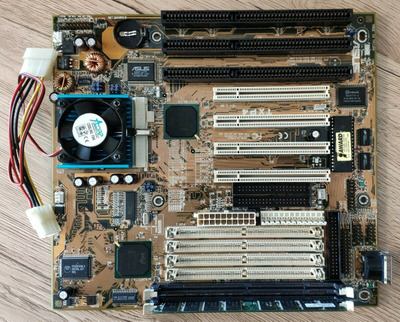

I just found an auction for a Kaimei Jamicon KM-T5-T1 on eBay. Tested and fully functioning. And for a reasonable price.
The board has both four SIMM and two SDRAM slots. Apart from some SDRAM modules on my Pentium 3 machine, I don't have confirmed good RAM modules. The seller told me he has modules of both types in stock. SDRAM is faster, so if I do buy the board I would opt for two modules of this type.
I can clearly see the FP header connections on the images provided by the seller. This page has a scan of the board's manual. The board's CMOS chip is powered by a CR3032, which is what I prefer.
Those who have been reading my topics know that I'm not a specialist. So I'd like to ask your opinion on this board. Seems like a good buy?
Reply 4 of 12, by Joseph_Joestar
I see some bent pins near the keyboard port.

Reply 5 of 12, by Odiseo
Joseph_Joestar wrote on 2021-06-12, 14:48:
I hadn't noticed this. Thanks for pointing it out.
The seller claims in the description that the board looks like new, as if it only recently left the production facility. The description is in Italian, which I understand quite well.
They have two boards of this model for sale.

Reply 7 of 12, by dionb
Odiseo wrote on 2021-06-12, 14:43:
I just found an auction for a Kaimei Jamicon KM-T5-T1 on eBay. Tested and fully functioning. And for a reasonable price. […]
Note that that board has an i430TX chipset. Generally it's one of the best So7 chipsets, but there's a big mismatch between supported RAM (256MB officially) and max cacheable area (64MB). Uncached RAM is slower, so you don't really want to use a board with this chipset with more than 64MB. A single 64MB PC100 DIMM is best memory choice for a board like this.
If you really want more RAM, go for an ALi Aladdin IV, V (G-revision or later) or Via MVP3 (with 1MB of L2 cache) board instead.
