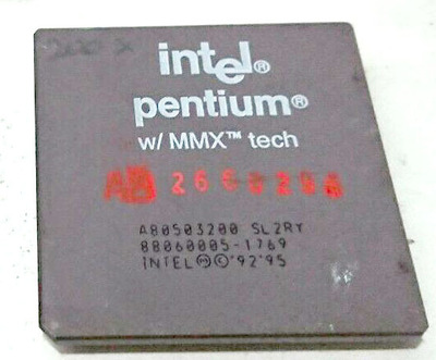

Reply 12 of 30, by iraito
Doornkaat wrote on 2021-06-12, 21:06:
Weird. Are you trying to overclock the CPU or is it a genuine 200MHz CPU?
Later Pentium MMX are multiplier locked. You can set the jumpers on the board but the signal won't be passed on to the die.
Let me guess, this is not a 200 cpu right ?

Reply 16 of 30, by iraito
Doornkaat wrote on 2021-06-12, 21:47:
Weird.
I'm out of ideas, sorry.
Thank you a lot anyway, i think this cpu might have some issue, i might try a new one in the future.

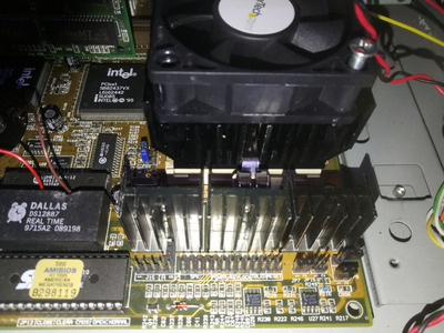

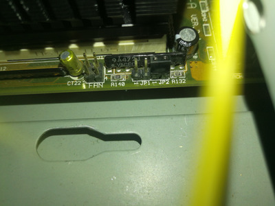

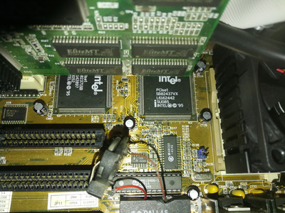

Hi, I've seen the pictures but from what I see I can't tell if it's a card that supports the Pentium MMX.
The CPU appears to be a 200MMX, excluding that it is not an original, the only reason it does not go to 200 is that maybe you set the jumpers wrong.
So I would say if you can put an image of the MB, in particular I would like to see the voltage regulators mosfet area, then CPU area, then I would like to see the multiplier and FSB jumpers.
This is to understand if this MB is set correctly for the MMX, the one you had before did not support it.
If this supports it there should be no problem getting it to go to the right frequency (200).
