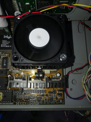

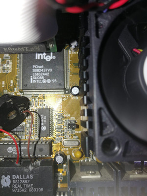

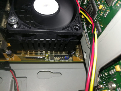

PC@LIVE wrote on 2021-06-12, 22:45:
Hi, I've seen the pictures but from what I see I can't tell if it's a card that supports the Pentium MMX. The CPU appears to be […]
The CPU appears to be a 200MMX, excluding that it is not an original, the only reason it does not go to 200 is that maybe you set the jumpers wrong.
So I would say if you can put an image of the MB, in particular I would like to see the voltage regulators mosfet area, then CPU area, then I would like to see the multiplier and FSB jumpers.
This is to understand if this MB is set correctly for the MMX, the one you had before did not support it.
If this supports it there should be no problem getting it to go to the right frequency (200).

Reply 22 of 30, by PC@LIVE
A ok then does not support the P.MMX or yes?
If it doesn't support it, you need to figure out how to make the mod to power it properly (add dual voltage).
The images I asked for were used to understand if it was a model born for normal Pentium, many i430VX can support MMX only if dual voltage is available, and from what I understand this card does not support it either.
I'll take a look at the link, but I doubt it's a simple thing to do (mod).
Reply 23 of 30, by iraito
PC@LIVE wrote on 2021-06-13, 19:04:
A ok then does not support the P.MMX or yes? If it doesn't support it, you need to figure out how to make the mod to power it pr […]
It supports mmx perfectly, i already tested 5 games all of which give me the results of a pentium 166 mmx (like quake running at 42fps) the motherboard is compatible and set for mmx, check the first post.
MIDI Devices: RA-50 (modded to MT-32) SC-55

Reply 25 of 30, by Repo Man11
This site lists 3 different versions of this motherboard (version 1, 2, 2.1) and they have .txt files for the jumper settings for each. The version # should be somewhere on the motherboard, so make sure of which you have and double check the jumper settings. https://pcrebuilding.altervista.org/52/6/TOTA … 5%2C7+AP-C.html
Reply 26 of 30, by iraito
Repo Man11 wrote on 2021-06-13, 19:53:
I have a 2.1 and i just noticed 1 thing, jp1 and jp2 seems to act as if they are always both closed, which would explain the constant 166.

Reply 29 of 30, by iraito
Repo Man11 wrote on 2021-06-13, 00:02:
This information is for a slightly different Biostar VX board, but it sounds as though it would be relevant to this one, so have a look and see if your board is the same or similar enough: https://www.vobarian.com/8500tvx.html
Well, this solved my issues, it was the multiplier, now it runs at 200 with no issues whatsoever.
