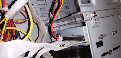

The floppy power cable adapter arrived, and now the drive works too. 😀

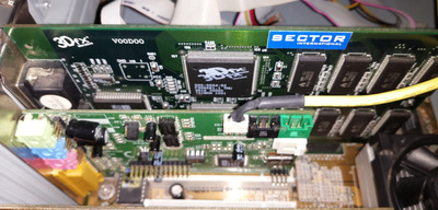

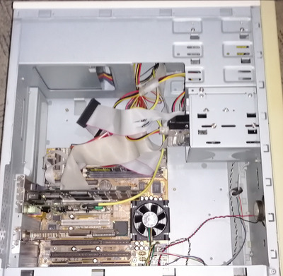

Here's a better look at the board now that's everything is inside:
585.63 KiB
1540 views
1.21 MiB
1540 views
1.23 MiB
1540 views
Yeah, lots of empty space, it's how it goes when you mix an AT board with an ATX case.
Even rebuilding a computer feels like building a "brand new" one, thats for sure.

Reply 42 of 62, by Joakim
Yeah lots of space in the case! I have my SS7 in a case like that because I refuse to buy an AT one for 100$. I'm sure I'll find one soon.
That motherboard looks very cramped around the CPU. At least you are able to fit a voodoo in there. My 5ali61 barely fits a voodoo 2.
What is Bector? Some local brand in your country? (Funny how the label sais international in that case.)
Reply 43 of 62, by Czeky
Joakim wrote on 2021-07-19, 17:32:
Yeah, AT cases became WAY expensive, its just ridiculous.
Yeah, my voodoo1 just has enough space to not touch the cpu. And that intel cooler definitely helps things cool down better.
It's Sector, and honestly I'm not sure, but looks nice so I've kept it on the card.
