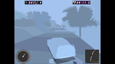

I would have one question: I finally got running my old CD version of this rally racing game from 1997 by Europress.
I followed the solutions on the following link on how to run this game:
https://www.pcgamingwiki.com/wiki/Internation … ly_Championship

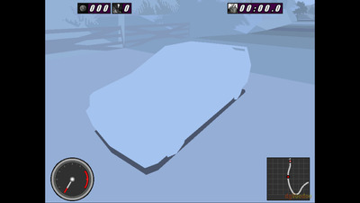

Well... it does work, kinda (the frames stutter a bit in the menus, that means 15-20 fps), but when I try to start a race, I've also got the following white/grey graphics (look at attachments).
Right now, I am using dgVoodoo version is 2.7.5, but I also tried some older versions (2.6.x and 2.55), but the result is the same.
Could someone please help me, what am I doing wrong?

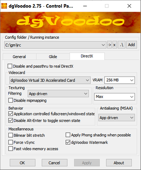

I am using mostly the standard dgVoodoo configuration.
My configuration: AMD Ryzen 4750G with Vega 8 graphics, 32 GB RAM, 1 TB SATA SSD, Windows 10 Home 64-bit version 21H1 build 19043.1052.

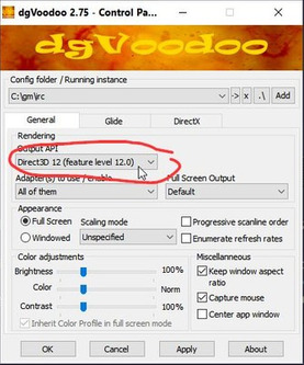

Hi,
You have an AMD GPU, so you should try D3D12 as output API (instead of 'Best Available'). See the appropriate section in the readme:
dgVoodoo D3D11 is broken with AMD GPU's (DirectX modules). I got a ton of reports complaining about solid colored polygons instead of textured ones. This problem seems to affect all GCN 2 and newer GPU's and I cannot do anything about fixing it. I don't have a clue what change in my code broke it and AMD probably won't fix their drivers so I don't care about it all anymore.
On the other hand, according to the feedback I got, D3D12 works as expected so this is your best bet on AMD hardware.

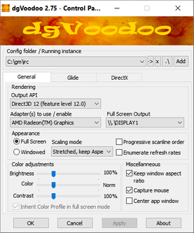

Reply 2 of 9, by opeter
Dear Dege,
thank you so much for your reply.
Sadly, if I try to set dgVoodoo 2.75 to DirectX 12 (feature level 11 or the other option level 12.0) I've got just a black screen for like a second and the game closes without any message. No "meditation guru error" or similar. Nothing.

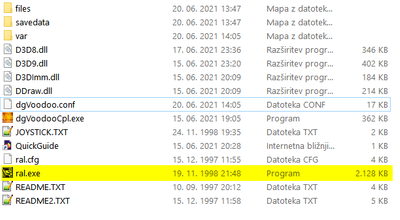

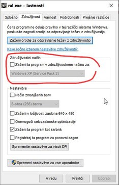

I had a quick look at this game again. So, after installing the original version from the CD, I could only run it in Win98 compat mode (but even then it crashed when entering a Quick Rally).
And indeed, only through D3D11. D3D12 + Win98 compat mode caused the nvidia driver to fail when checking the PE signature of its dll's (win98 version of imghelp.dll again?).
However, there is an XP-patch for this game, you can download it from a site that I don't want to advertise here (it's always subject to debate if they are pirating or not).
For me the XP version (without any forced compatibility mode) ran through D3D12 finely.

I also tried to change/select the adapter to AMD Radeon(TM) Graphics and configure the display option to \\. \DISPLAY1 but no change at all.
If I select DirectX 12 (any of the two options), the game simply doesn't load or should I say it loads for a second with black screen and right after that I am back at the desktop.

Reply 6 of 9, by opeter
OMG, I cannot believe this!
It does work!!! I don't know what ral.exe file did I find (I already applied the 4.80 patch in the beginning), but yes, it does indeed work wirt DirectX 12. 😊😀
I made a very short gameplay video:
https://drive.google.com/file/d/1i-tjqtxSJuBO … iew?usp=sharing
The ral.exe size and date I am using is in the screenshot. Oh and I don't use any compatibility mode, just "run as administrator".
And even the upscale is working. Beautiful! 😍😎

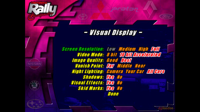

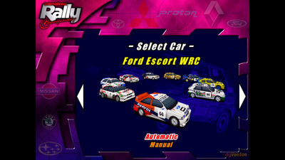

Reply 7 of 9, by opeter
A little bit of nostalgia 😊
Reply 8 of 9, by De-M-oN
fast memory access can be used with this game (and with the very most others as well)
And use 8x MSAA and 16x Anisotropic Filtering in dgvoodoo. Makes wonders.
