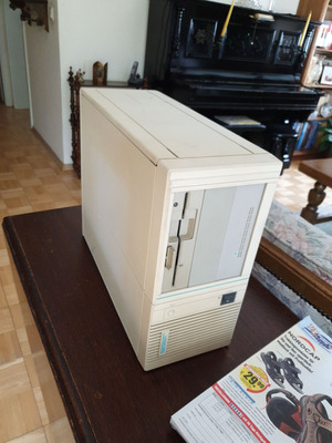

Since i took the 286 from the house of my Parents witch was not used for many years to my flat last year i was modifying it one after another.
This is how it looked like at the beginning

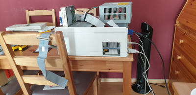

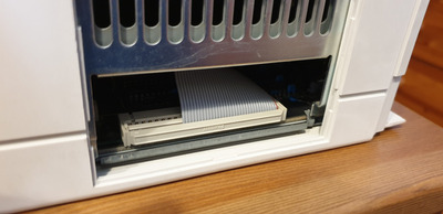

The original Floppycable has only edge connectors so i hooked another one with additional 34pin connectors to the original 50pin connector
275.25 KiB
1644 views
136.89 KiB
1644 views
Yes the newer cable allows me to use the 5.25 and the 3.5 inch floppy drives ! 😀
394.58 KiB
1644 views

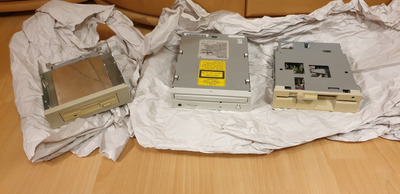

On the front of the 5,25 adpter for the 3,5 Floppy i had some space for hooking up an external LED for the HDD activity of the CF card.

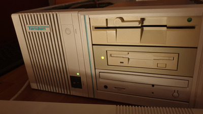

Since I swapped the RLL HDD out there was then space on the bottom for the 4xspeed CD Drive witch I connected to the IDE-INTERFACE from the SB16.
1.04 MiB
1631 views

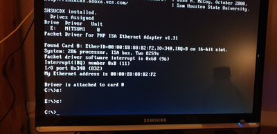

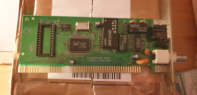

The last upgrade until now is the ISA network Card with RJ45 connected to my daily pc so I could use mTCP and Filezilla to copy some files very easily and faster than a connection via Nullmodem on RS232 👍
910.68 KiB
1631 views
297.15 KiB
1631 views

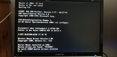

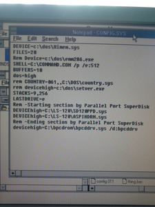

The reason why the CD Drive was not attached is because the drivers for CD load on config.sys before unisound is loaded witch activates also the IDE-INTERFACE from the Soundblaster.
Shown here
940.96 KiB
1600 views
With Devload.com copied on your bootup-drive you can load CD drivesrs after unisound is loaded and so your IDE interface.
Here is how it looks like now
344.71 KiB
1600 views
Here on the photo of config.sys I forgot to delete the line with the VIDE-CDD because now it's loaded by Devload in Autoexec.bat ☝😉
283.36 KiB
1600 views
248.2 KiB
1600 views

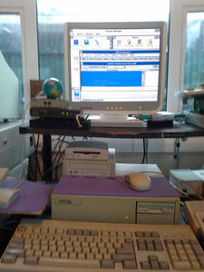

Here's a pic of my Zenith 286LP Plus(286/12) with 8megs of ram. Runs Dos, MS Windows 31, nic packet drivr, winpkt, and a few straight Dos applications Like you I'm using new technollogy to enhance it. It has an external Backpack CD reader, external LS120 drive daisy chained to the Backpack, nic as well as a nice white beige Packard Bell FT700 LCD Monitor. I pinched the Windows for Workgroup 3.11 FPT and TELNET clients and their help files. When Windows loads it starts the Trumpet Winsock for TCIP. Once in Windows I fire up the IRC client PIRCH to access my favourate IRC channels....😉

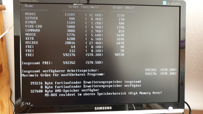

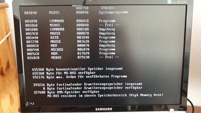

Reply 12 of 24, by GuillermoXT
Caluser2000 wrote on 2021-07-07, 20:34:
Wow this is pretty cool🙂👍
Would DR-Dos be able to use the 3mb xms so in total programs could use it as conventional memory?
Even with the card Dos tells me having less than 1mb of conventional memory

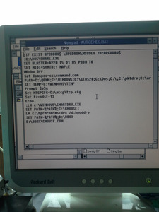

Reply 16 of 24, by Caluser2000

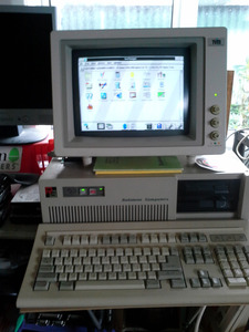

Here's my 286s' autoexec.bat file...😉
    576.69 KiB
    1478 views
