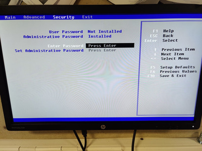

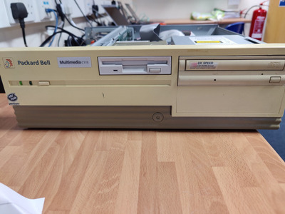

In need of some advice. Recently picked up a C115 Packard Bell off eBay but it has a password set on it that I can't clear.
tried removing the CMOS battery for over half an hour which made no difference.
Can't find a clear CMOS switch on the mobo.
Photo's attached.
Any help would be greatly appreciated.

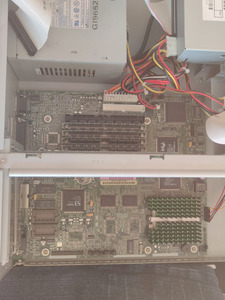

Reply 3 of 10, by unospace
Here's a photo of the board.
Kinda hard to take with the big bar across the top.
Does it help identify the mobo?
Cheers,
Matt
Reply 4 of 10, by dionb
unospace wrote on 2021-07-14, 17:07:
Here's a photo of the board. […]
Cheers,
Matt
Yep, that's clear enough. Intel NV430VX, or in PB-speak PB682 'Orlando 2D'
Here's specs & info: http://uktsupport.co.uk/pb/mb/682.htm
J1F2A is the jumper you're looking for. Setting it to 2-3 should do the trick.

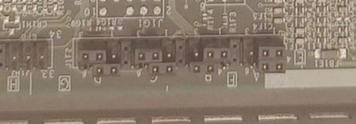

Quick question. I can see the jumpers. Which one is it though?
There are multiple jumpers along the bottom of the board.
Sorry to be a pain!
Matt

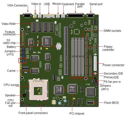

Reply 7 of 10, by unospace
Found this online.
Have marked the image location with a red square.
Let the fun begin tonight hopefully.
Thanks for the help though dionb, very much appreciated.

Reply 8 of 10, by dionb
unospace wrote on 2021-07-15, 08:06:
Sorry to be a pain!
Matt
The whole block is J1F2. It's divided into sections A-D. Within each section the pins are numbered. So I would expect there to be a jumper over pins 1 and 2 on J1F2A (and judging by the pic, that is the case); that jumper needs moving to 2 and 3.

That worked perfectly. Moved the pin to 2-3 and it no longer has a password set on it.
