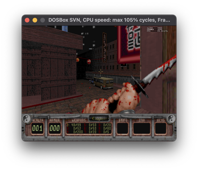

Reply 8 of 67, by kjliew
Shadow Warrior USA with BUILD_FPS=1 for performance stats measurement
Native AArch64 DOSBox SVN CPU core dynrec with Kekko's Voodoo chip emulation.
QEMU won't be able to play this game with Glide pass-through, so DOSBox SVN just fill the shoes then. 😉
It was captured in windowed 800x600. Fullscreen mode 640x480 will have better FPS. It is still too small to play at 800x600 in retina screen and 800x600 fullscreen mode switch seems to be broken in macOS Bug Sur or Apple just didn't care to emulate it properly. I think external standard display should work in windowed, but I don't hook up mine with any.

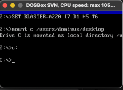

rosetta2 64bit build:
PCPbench dynrec64 127,5, normal 23,7
But all this with output surface, your opengl fix doesn't seem to fix it, only makes it "different" to what was the problem before.

windowresolution=2048x1280
scaler=none
I have `output=opengl`. Otherwise, `output=surface` caused crackling in Munt MT32 audio in games such as GODS and LSL3 which I don't know why. For both games, cycles was set to the default 3000 with normal core, so the audio crackling wasn't due to CPU hogging AFAIU. With `output=opengl` or `openglnb` , it cures all the audio issues even before I had the fix. I don't have audio issues on Ryzen laptop regardless of any output type for those 2 games be it on Windows or Linux. So I would say the OpenGL fix is more critical for DOS games, the dynrec is just for a show. 😉
This is the same for Windows build, too, for high display scaling. Otherwise, it will just be the same tiny rect in windowed for those with Surface 4k panel crammed into 12.2 inch. I used to be able to get DOSBox SVN WIN64 to respect OS display scaling, so a 640x480 will look like 640x480 after display scaling but I couldn't reproduce the build anymore.

ok, tested it again without the fix and opengl works fine just out of the box for me... huh...
So on my MacMini M1 OpenGl works right away. The only thing (that so far has never been an issue) is that the MacMini is not hooked up to any display and is remote desktop controlled.
I did have OpenGl problems on the DTK machine that's why I thought this would still be the case and didn't even test it again and just assumed I'd still have a problem as you wrote you had one (on the DTK the DOSBox window was the right size but the actually displayed part would be much smaller in the lower left part of the window).
This makes this not easier 🙁
The culprit could be the SDL 1.2 you are using... My SDL 1.2 was built from their development version of March 13 2021 against SDK 11.1 with deployment traget 11.1.
And it's NOT using X11 which might be a possible clue since you are relying on X11 for your other stuff.
On intel macOS all other output than opengl was very noticeably slower, btw. Curiously that is not the case via the Rosetta2 emulation, surface is reproducibly only slower by 3 or 4 fps.

That's what I have been yelling *Display Scaling*. If you do remote desktop or Hackintosh on VM, then there is literally no display scaling in action.
If it drives a local retina display, such as the MacBooks, or a 8k/4k panel at 27 inch on the MacMini, then I think you will see the problem. This is not just macOS, it is everywhere, but Linux typically has poor usage of display scaling.
Dominus wrote on 2021-07-16, 21:43:
This was exactly my OpenGL problem before the fix. Are you sure the window size was right? It was only *looked* right because the window was created taking display scaling into consideration while OpenGL rendered at real screen pixels. That's the reason display stayed in the lower-left part of the window.
