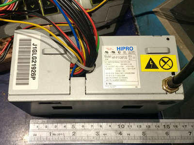

Reply 3 of 17, by BitWrangler
PSU only seems to fit in one place... this is with the keyboard connector to the rear. Ignore the green board on the I/O strip, that would come off. I'd be okay with the I/O on the side, but it's got the VGA at the front and the PS/2 mouse at the back which is just wrong. Maybe I want the kb coming out the front, the I/O on the left, then ps/2 is forward and vga to rear, and the PSU will flip over and the wire won't be across the center of the board. However, this puts the CPU more under the floppy, which means a heatsink rethink maybe... unless it still has a cm or so above a low profile fan. Got a slightly shorter sink, but that would need more fan methinks, so might not save height.

Reply 5 of 17, by BitWrangler
Thanks. Current one is 65*80*170 approx, so possibly not worth a purchase for the 30mm in length saving, which isn't really the dimension where it would matter much.
I used to have something about 30mm deep and 120mm square, think it had AT connector, think it was around 120W. Problem with that one is, I can't even remember if it came to this house or not, or whether it was discarded 1, 2 or 3 moves ago. That was probably by Asetec or HiPro who seem to do all the strange ones.

Reply 11 of 17, by BitWrangler
Scored low on that session of 3D Tetris, I didn't think that PSU would help much and it won't. If it was all I had I could make it work with a whole new set of compromises, just a bit of a pity, as it became apparent I'm not using much of the potential of the TFX unit, so woulda been good to save that for a build that needed more of it. However, TFX supplies seem to turn up cheapish in surplus, so I could get another one later if I think of something I really wanna do with it.
