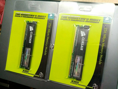

Reply 1 of 25, by Jackhead
Very happy found the RAMs maybe the best you can buy for the socket

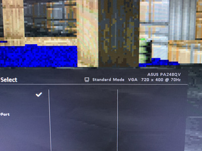

Today i got the Asus TFT. First tests with My Dos rig:
1.98 MiB
2060 views
1.81 MiB
2060 views
70Hz with IPS on Dos

Sorry if this sounds like nitpicking, but the points below are worth knowing about, IMHO. However, they may not bother you, in part or at all.
a)
70Hz input support, at least over VGA, is a given for backwards compatibility reasons, however not all monitor actually display 70Hz (frameskip) and not necessarily on all inputs (VGA vs HDMI). AFAIU, your monitor is capable of up to 75Hz ( both input and display), at least over HDMI .
b)
That monitor does not have a 4:3 mode that works for 640x400 (320x200 line doubled by VGA card), so most VGA DOS games will be stretched horizontally.
c)
Are you bothered by the fact this monitor, like practically all TFTs, samples 640x400 (320x200 line doubled by VGA card) ? An example of the effect of this can be seen in the uneven with of the lettering on Doom's HUD (bottom right).
If point a) is an issue (might not be, might not bother you if it is), an OSSC can address it.
Point c) can also be fixed by an OSSC .
Point b) is not fixable by an OSSC. An Extron RGB DVI 300 (or its HDMI version) will fix b) and c) but will force 60Hz, add a little latency and not be as sharp as an OSSC
See Re: Purchasing a 4:3 LCD for DOS/DOSBOX/MISTER/OSSC games? for more info on that monitor

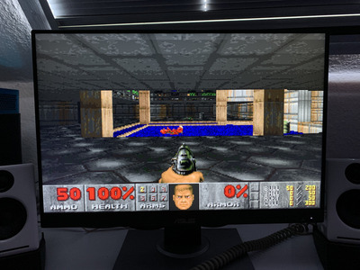

Reply 11 of 25, by Jackhead
Further testing. I got 4:3 working with the Asus
ossc+framemeister combi
1.52 MiB
1978 views
Used hdmi source from the ossc to the framemeister , output mode DVI. Than i choose aspect ratio 4:3 on the framemeister. After that i can activate 4:3 on the Asus. But i see the 60Hz Problem darry talking about.

Reply 12 of 25, by darry
Jackhead wrote on 2021-07-22, 20:42:
Further testing. I got 4:3 working with the Asus […]
Cool!
I did not realize you that you have a Framemeister (well regarded but expensive piece of kit). I am not very familiar with it. Does it preserve 70Hz or does it convert to 60Hz ? Also, AFAICR, the Framemeister only outputs in YCbCr at 4:2:2 , so I wonder if there might be any noticeable image degradation due to the RGB--> YCbCr conversion and chroma subsampling .
EDIT: I see you answered my question about 70Hz. Sorry, I missed that initially . I have gone through about 5 or 6 scaler/digitizers and found only one (and likely its rebranded clones) that preserves 70Hz, but it only does so when outputting 1024x768 and only accepts 70Hz when receiving 720x400@70Hz . That unit is the Cypress CP-254 DVI to DVI scaler . It is not without its shortcomings, however . See Re: What are the best Vga to hdmi scalers or peripherals for MS-DOS games ? .
With any currently available monitor with or without any available (including discontinued ones) scaler/digitizer that I could find, the only way to preserve both 4:3 AND 70Hz in DOS games is to have a monitor with an explicit 4:3 mode . If there is any other way, I would love to hear about it .
