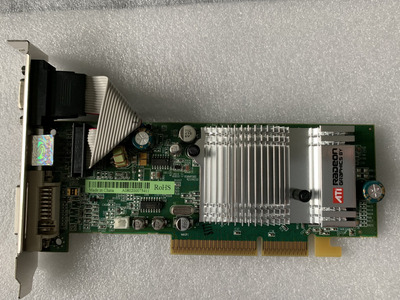

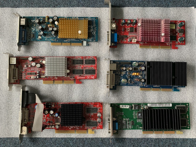

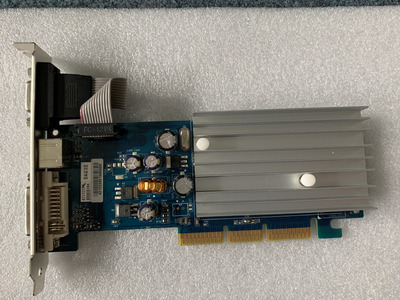

Hi,
what do you think about these cards? What will be the better choice in terms of
- performance
- featureset
- compatiblity to older games/API's features
- output-quality
AGP-LP Radeon 7000
AGP-LP Radeon 7500
AGP-LP Radeon 9200 256MB 128BIT
AGP-LP Radeon 9550se
AGP-LP Radeon 9600 le/se
AGP-LP Radeon 9600M-T64
AGP-LP ATI FireGL-T2
AGP-LP GeForce 440mx
AGP-LP GeForce MX4000
AGP-LP GeForce FX5200
AGP-LP GeForce 6200
Or should I go for another card?
Thx
Doc
Some cards I do already own...

Just going in blind without knowing the specs of these cards, I'd say the MX440 should be one of the top tier choice. The Radeon 9xxx series (including the FireGL) could also be good, but I don't know if they support all the features for early W9x games and that also stands for the GF6200, while the MX does. The rest are slower than the MX440 but not more compatible.

GeForce MX 440
Generally quite compatible with old stuff. Does not support EMBM though, so Expendable and Dungeon Keeper II won't work will all bells and whistles. Almost all LP variants have performance of MX420 due to 64-bit memory bus. MX4000 is always 64-bit.
GeForce FX5200
LP variants are horrible, just big NOPE. Compatible, but slow.
GeForce 6200
Fast (in some cases fastest card in the list), but has problems with old stuff and does not support paletted textures due to removed feature in driver.
Radeon 9200 256MB 128BIT and 9550/9600 (assuming they are also 128-bit)
Fast and compatible with old stuff. May have some problems here and there, but nothing serious. Some stuff can be adjusted via fanmade tweakers.

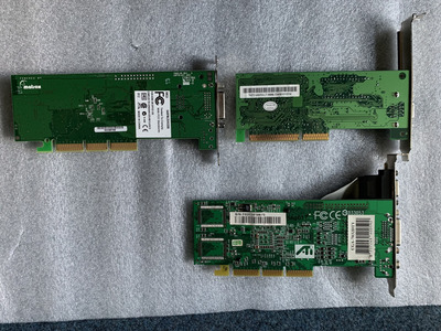

Some other cards I have found yesterday

That's DVI only G450 and of course it has win9x drivers. With some overclocking, should be fast as TNT2 Ultra. Obviously slower than most cards here though, especially in OpenGL.
Interesting, thx!
