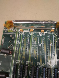

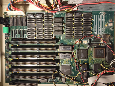

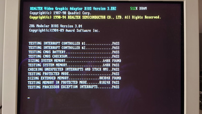

Hi retro tech guru,
I have a motherboard with 286 CPU which works fine after some repairs, but I can't figure out how I could increase a memory. BIOS shows 512KB of memory and no extended memory at all. I tried to remove one of 4 RAM chips (16 pins) to see any changes in BIOS, but no changes which is odd.
I would like to install 4MB, which seems to be maximum for this board, but I can't find any info regarding "511000". I assume these are RAM chips which I need to install in BANK 0 and BANK 1.
Any help is very appreciated!
Reply 2 of 27, by mkarcher
You have 2 banks of 512K each, which should be treated as 512+512 or 640+384, not 512+0. It seems the memory in bank 1 is not correctly recognized. Possibly one of the chips is broken.
The Chip numbers printed on the board are generic, and many chips have slightly or considerably different naming schemes. For example, your V53C104 chips are called 414256 in the silkscreen. If you want to go full 4MB, you need 36 chips, each of them "1M x 1". Examples for this kind of memory chips are Fujitsu MB81C1000A, NEC µPD421000C (often spelled UPD421000C), MCM511000A. Searching for "1M x 1" DRAM DIP should yield enough results to find offers for the chips you need.

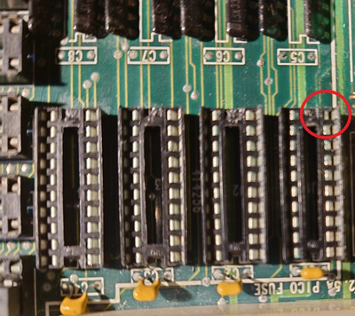

Good news everyone! After some test I found that one leg of the socket for RAM chip is damaged by corrosion. So new sockets are soldered and now RAM is working as expected 😀 Will dump bios as soon I will have a time for it 😀 Thanks for the help!

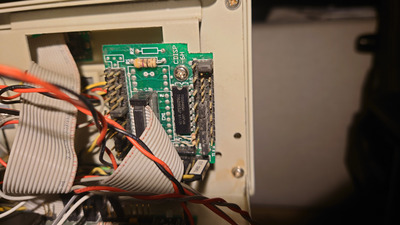

Now I have another issue 😀 Turbo switch. Display reports 16Mhz, but diagnostics show 8Mhz. If I disable turbo, PC doesn't even starts. Maybe someone could help with correct jumper settings for board (picture attached)?
Thanks in advice!

I assume that issue is not related to "turbo switch board". If "TURBO" pins are open motherboard is not get POST BEEP, if pins are shorted it BEEPs ok and shows 8Mhz with diagnostic tool. Any ideas what could cause such behavior? Of course if my assumption that shorted TURBO pins enables TURBO 16Mhz is right.

aknot wrote on 2021-10-22, 19:06:
Thanks,
Your BIOS has a "Speed Select" setting - No Change, Low, or High. How do you have that set?
Reply 19 of 27, by weedeewee
Broken or faulty contact on one of the oscillators ? looks like you've got two, one I assume 16 MHz, divided by two would give the 8MHz cpu speed, and one 32MHz which would deliver the 16MHz.
One of the ceramics around them could also be at fault.
