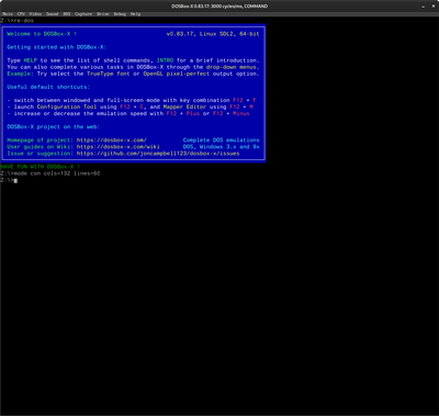

DOSBox-X supports copy and paste of text. You can copy a text screen to your clipboard for instance. It also supports TTF fonts in text mode, and higher text modes like 132 columns and 60 lines.
