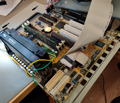

I recently acquired a PC with an ASUS P2B-B Rev 1.01 running a P2 350.
The board revision is 1.01 which officially supports processors requiring a minimum of 1.8V, so basically no Coppermine CPUs.
ASUS made a Rev. 1.02 of this board that does support 100mhz fsb Coppermine processors, so I was interested in what were the differences, and would it be possible to somehow mod the older revision board in a similar manner.
After some digging around the net, I found this link, where it mentions you can potentially swap the voltage regulator chip, and along with the latest bios, you should be good to go:
https://web.archive.org/web/20150322010811/ht … pgrade_faq.html
I also found another post of someone actually trying this:
https://diarywind-com.translate.goog/blog/e/a … B&_x_tr_pto=nui

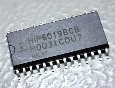

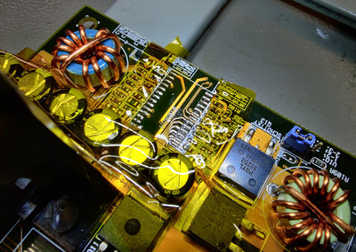

The Rev. 1.01 board has an Intersil HIP6019CB PWM controller, and the Rev. 1.02 has an Intersil HIP6019BCB PWM Controller.
I looked around on eBay and managed to find a Chinese seller that claimed to have the chip, it was cheap, so I took a chance and ordered it

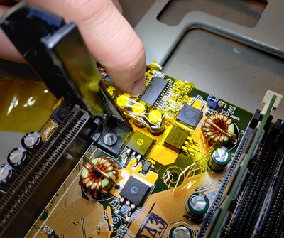

The chip eventually turned up, and I took it to my friend who is good with electronics, and he said it's difficult to check the functions of the chip out-of-circuit, so he did couple of basic tests, then we just had to give it a shot and hope nothing smoked.
The attachment IMG_20211220_183647__01.jpg is no longer available
Installation:
The attachment IMG_20211220_185227.jpg is no longer available
The attachment IMG_20211220_190008.jpg is no longer available
The attachment IMG_20211220_190306.jpg is no longer available
The attachment IMG_20211220_191228.jpg is no longer available

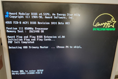

Reply 1 of 13, by RockstarRunner
First test done with no cpu, ram or anything else connected, no pops or smoke, so far so good.

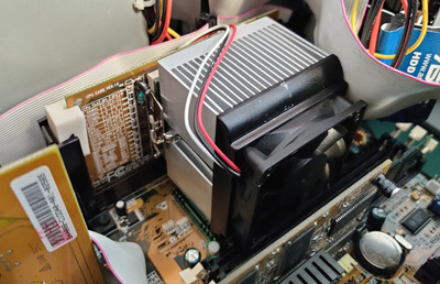

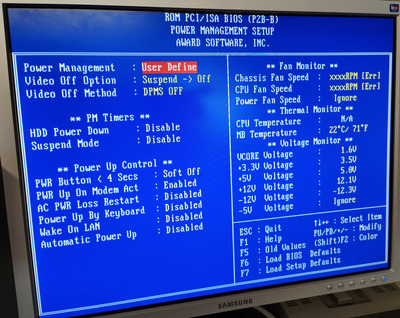

Next we added the P2 back to the system, along with some ram, the machine posted as normal, and the bios reported a VCore of 2.0V (this is correct for the P2 350).
Then came the big test, swapping out the P2 for a P3 850 Coppermine SL43F https://www.cpu-world.com/sspec/SL/SL43F.html
The attachment IMG_20211220_193223.jpg is no longer available
The attachment IMG_20211220_193155.jpg is no longer available
The machine posted, reported the CPU correctly, and the BIOS showed a VCore of 1.6V
I put the system through a series of tests in windows, and it performed perfectly. Result!

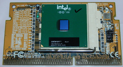

After doing the above mod allowed me to run Coppermine processors, I then started looking into Tualatin adapters.
I picked up a Slotket adapter off eBay, one which supports Coppermine CPU's (important, most just support the old Celerons)
The attachment slotket.jpg is no longer available

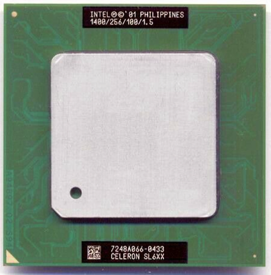

Then I purchased a 1.4Ghz Tualatin Celeron (100mhz fsb) with built-in coppermine adapter from a eBay seller in South Korea (well known to these forums I believe)
The attachment tualeron.png is no longer available
The attachment IMG_20220216_113627.jpg is no longer available
The Tualeron runs with a 1.5V V-Core, which the new voltage regulator will happily supply.
The bios recognizes the CPU, but does issue a warning that the CPU is pulling only 1.5V, but this can be ignored, as I think it's just the BIOS not expecting such low voltage CPU.
Everything is working fine, and I'm happy this board is now even more flexible.
Reply 6 of 13, by rasz_pl
So I looked it up and Im confused. Original Tualatin mod required joining 2 pins together and isolating 3 pins from the board. Did you have to cut CPU pins/did it come with pins pre-cut?
Reply 7 of 13, by RockstarRunner
Adapter (like a thin PCB that fits under the CPU) came pre fitted, so I didn't have to do anything than put the CPU in the slotket. I believe he cuts those pins when he installs the adapter.
