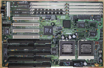

I have one of these boards a (s1564D) and it’s just the greatest thing since sliced bread. So stable, just works so well! Really love it

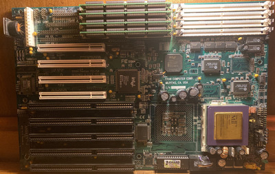

Well, the other day I was browsing around and came across a good deal on a S1564 so I bought another haha except this one is a s1564S the single socket version! Bummer…
But,
With some advice and help from the wonderful guys on this forum and on the discord server I’ve been preparing to convert it to a s1564D
This will be the build log for the conversion
Here are the before photos:

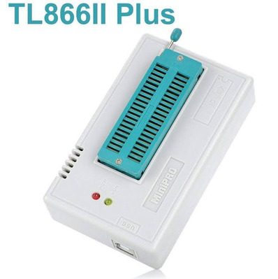

The first thing I’ve done is flash the latest jan bios to the board for the S1564D using my chip programmer. http://web.inter.nl.net/hcc/J.Steunebrink/k6plus.htm
45.51 KiB
4656 views
Pretty easy stuff,

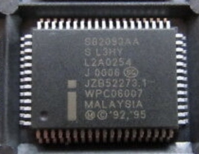

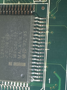

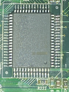

Now I need to install the APIC
40.97 KiB
4651 views
Luckily, this board doesn’t really seem to be missing anything other than the APIC, the socket and possibly a jumper or two

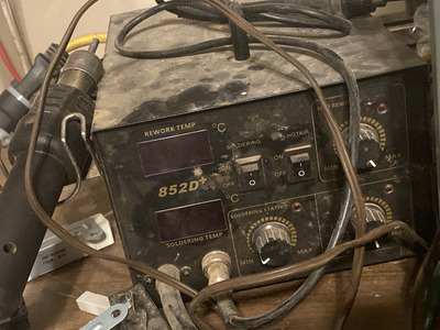

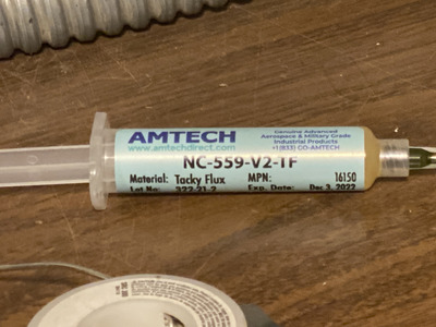

I used a hot air gun and some of this cool soldering paste
1.6 MiB
4651 views
1.04 MiB
4651 views
First I dabbed a little solder on the pads of the apic then lined it up on the pads and pushed down and went around it with the hot air gun two pics because it looks weird in the first, but it’s all good

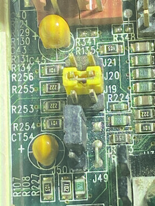

Next I have to add the single/dual cpu selector jumper
Not really sure of the purpose of this jumper because my dual works fine with it in the dual position even with a single processor.
Might be responsible for switching on the use of the apic vs using the internal apic in the processor which is probably why it works on a single. Idk I’m just guessing.
Might be kinda neat to see if the external APIC or internal performs faster in single chip mode with a K6
Here you can see the new jumper all installed and ready to go.
(Black one)
1.21 MiB
4642 views

Well that’s enough for tonight, unless one of you keen eyed electronic wizards sees a difference I missed I think the only thing left is the socket I even fixed the missing I/O ground tab on the kb port
I’m still waiting on the rtc and a atx to AT adapter so no big hurry.
I may even just leave it at this stage for a while.
I was hoping to find a exact match for the socket that’s in it but the AMP one that I ordered is a little different. I kinda want it to look original. So if anyone has a busted tyan laying around lemme know.
The board so far as it knows is a dual now, just no socket, I don’t have a pair of 233s for it, just 200s might just run a k6 3+ 400 in it for a while and compare to my dual 233
Power leap and cyrix just because it looks cool.

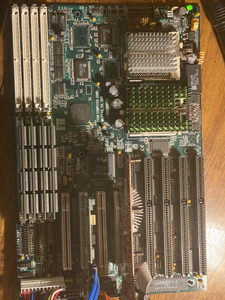

Well, I got bored
Went ahead and just used the AMP socket.
1.91 MiB
4525 views

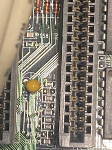

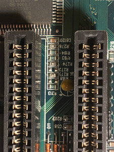

I did notice this: (thx lucky bob) but haven’t done anything about it yet
1.25 MiB
4525 views
1.12 MiB
4525 views

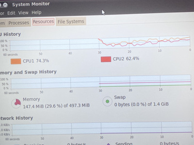

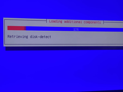

It seems to post just fine but the RTC is being an issue.
I tried to start windows setup but it needs sata drivers, screw it. Gonna throw ubuntu on it and see what happens

Reply 11 of 94, by Sphere478

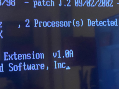

🧐 It appears that I have two cpus at my disposal
1.69 MiB
4487 views

Reply 12 of 94, by Warlord
Interesting to see that the single socket variant wasn't more crippled than the dual socket board. It would of been a good value back in the day. The dual socket board would of been a rip off for the consumer if you really needed dual socket back then. Since the missing components really isn't expensive.
Sphere478 wrote on 2021-12-23, 15:05:
I did notice this: but haven’t done anything about it yet67170689-57EE-4055-8E22-20B3BD17B66A.jpeg92BF016D-3AC8-4C16-91BF-D41CC4DA1D55.jpeg
This looks to me more like a pcb revision and less like a revision related to dual or single socket.
Next step is solder on more L2 Cache?

Reply 14 of 94, by Sphere478
Memtest is saying 1 core.. 🤔 (edit: memtest problem not board problem)
Trying windows xp install

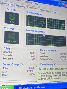

Reply 16 of 94, by Sphere478
XP says two cores…?
Thoughts?
Anyone with more knowledge on the apic have any ideas if those resistors might be why memtest doesn’t detect two cores? (Edit: memtest was the problem, not the board)
What are they for? Hesitant to modify them without more understanding dual processor seems to be working in linux, post, and windows XP
    1.33 MiB
    4411 views

Reply 17 of 94, by luckybob
I just finished a project and i saw my dual tyan board and it was easy to access!
My board https://imgur.com/a/qEd0d1S
My board is a s1562, but the numbers on the resistors are easy to read. As I recall, the chips are all identical.

luckybob wrote on 2021-12-24, 07:32:
I have two of these boards one is a dual from tyan and this one was a single.
It’s interesting your board seems to have yet a third configuration for those resistors..
