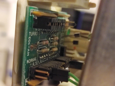

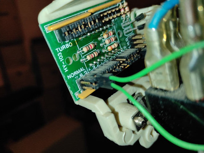

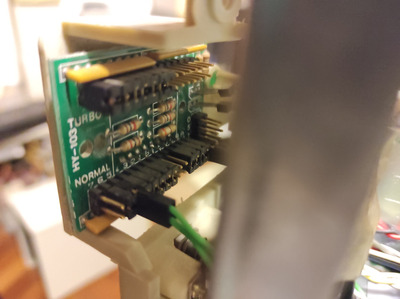

Hello, I just got a case with 2 digits turbo display, but I never messed with it and I would need some help about how it works.
Actually it shows always 30 when the turbo button is pushed or not.
I tried to find so called HY-103 but without any success.
Sorry for the bad pictures but that thing won't come off from the case.

It seems your kind of speed display is not mentioned on http://www.minuszerodegrees.net/led_speed_dis … eed_display.htm . The wire connector on the "normal 5" jumper position looks strange. I can only guess some of the information you need to make proper use of the display, because I don't see the most important stuff.
What I do see:
  • There are separate jumpers for "Turbo" and "Non-Turbo" to configure the displayed speeds.
  • The number 1..7 seem to indicate the individual 7 segments of the tens and the ones digit.
  • Most likely, the jumpers directly close the circuit, so a jumper that is set turns on the corresponding segment, a jumper that is removed turns off the corresponding segment.
  • In the Turbo block, one digit has all jumpers set (it will display as "8"), and the other digit has all jumpers removed (it will display blank). This seems to indicate that the display used inverse logic compared to the mainboard and the system that was originally in that case displayed "8" non-turbo mode.
  • Obviously, the left jumpers are for the ones display, and the right jumpers are for the tens display.
  • In the "normal" block, in the tens section, two jumpers are not set. This matches your observation that the tens section displays a "3".
  • In the "normal" block, in the ones section, one jumper is open and one jumper position has a cable connected. As you say the ones display is "0", which has only a single segment turned off, the cable seems to behave similar to an installed jumper.
  • Thus I conclude that the display currently displays what you set in the "normal" section
The most important question is, though, how does the display know whether the system is in turbo mode or not. This information is received via some pins in the bottom right block. To make an educated guess on how that block is to be connected, I would need to know all the letters next to the pins, not just the "O", the "S" and the letter that might be a one or an "I".
As your display is displaying something, it seems the power is connected correctly, so you can assume that the pins the power supply is currently connected to are indeed for connecting power.

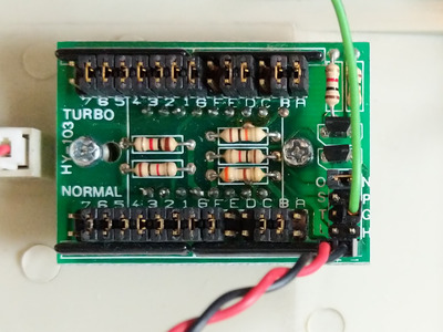

Thank you for your precious clarification.
Indeed the display shows 30 (the cpu is a 300 mhz, so it makes sense the choice), but the showed frequency doesn't change if the turbo button is pressed.
I was able to take a better picture:
107.88 KiB
856 views
Do you have idea of what the O S T connectors mean?
Thank you.
Edit: by any chance, do you know if there is a easy way to change that circuit board with a 3 segments turbo led? Are they available anywhere for a reasonable price?
In some turbo displays, "S" is used as input from the mainboard to tell the display whether the system is in turbo mode or not. Often, this is just a single pin. T (as T+ and T-) often is the connection for a dedicated turbo LED (as the mainboard turbo LED output is connected to the speed display, the Turbo LED can't any longer be connected to the mainboard). I have no idea about "O" or "zero".
For a first assesment of pin functions, it would be helpful if you can find out wheter some of the six unused pins are directly connected to ground or +5V.

So I did some further test, the display doesn't change the frequency showed when turbo button is pushed because the motherboard lacks the proper pin header (no surprise since it is a ss7 board).
The green wire showed in the picture, it was used because who assembled the pc lacked a jumper, I suppose, since I took it off and put a jumper.

Hello. I have the same type of display and need a bit of help.
What I already understand:
  • The 2-pin header labeled +/- is for power (red/black wire in the pic)
  • The segmented LED is configured to display either 20 MHz in normal operation or 40 MHz in turbo operation.
  • The G-pin is a single wire (the green one in the pic), which is currently connected to one pin of the mainboard's TB-LED header. So this is probably how the display senses which state the system is in. This is currently working correctly.
What I couldn't figure out yet: How do I connect the 2-pin turbo LED of the case? Since the TB-LED header on the mainboard is now used by the display, I'd assume that there's another TB-LED header on the display PCB...
So using a multimeter, I measured the T-pin against ground, which indeed reads 5V when in turbo mode and only a few mV in normal mode. But the adjacent pins labeled S and L are not directly connected to ground, so I am hesitant in placing the TB-LED header on there...
Any ideas?

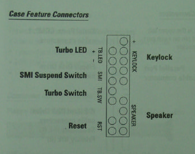

The motherboard has those connectors:
233.57 KiB
622 views
Mb header
I have 2 turbo connectors: 3 pins (orange, black and white) and a 2 pin (yellow and white).
This is how I connected the stuff: 3 pins cable from TSW to tb.sw on the motherboard, two pin cable from the led on the case on the motherboard.
The 5v+g on the turbo panel is unconnected.
With this configuration when the turbo switch is pressed (and the led is on) pc goes full speed, when the button is unpressed (led off) goes slow and the led panel shows nothing
