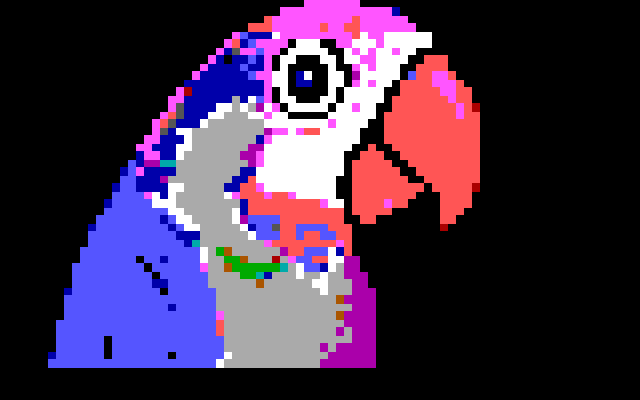

BTW, for anyone interested:
The ZIP of the Creative Talking Parrot attached previously in this thread is missing a few files. The ZIP attached to this message contains them, and are the CGA text mode (ANSI graphics) files for the program that *also* shipped with it.
Unzip to your hard drive where you have the CTP installed, and start the program like this:
PARROT.EXE /T
    2.55 KiB
    15392 views
    Creative Talking Parrot Running in Text Mode
