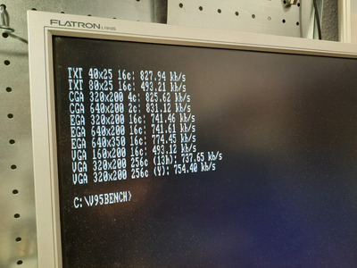

Hi everyone! I've been developing lately a new benchmark to test the bandwidth of old GPUs on DOS systems, given the knowledge adquired while developing FastDoom.
I'm releasing a pre-release version, this pre-release only tests write to VRAM transfers using 8-bit transfers, next releases will include more tests and more supported video cards. Bugs are to be expected on this release.
The supported video cards are the following:
  • MDA
  • Hercules
  • CGA
  • EGA
  • MCGA
  • VGA
  • ATI Small Wonder series
  • Plantronics ColorPlus
The release include two executables: V95_16.EXE is a 16-bit real mode executable (supports 8088/8086 cpu's onwards) and V95_32.EXE is a 32-bit protected mode executable (supports 386 cpu's onwards).
As always, the project is open source and you can take a look here: https://github.com/viti95/V95bench/
Download: https://github.com/viti95/V95Bench/releases/tag/0.0.1

Reply 3 of 7, by zyzzle
Do you have a new binary which incorporates the most recent changes (16-bit, 32-bit transfers, 640x350 mode) which I see listed on the github source?
The only binary I can find is the old 0.0.1 version with the 8-bit only transfers.
Thanks for making this benchmark. New DOS benchmarks are always very much appreciated...
Reply 4 of 7, by ViTi95
Yeah, the latest version i've uploaded is the 0.0.3, it includes all new 16-bit and 32-bit write to VRAM and read from VRAM benchmarks. It's still a pre-release, since the UI is still horrible, and missing some important functions like export to file results.

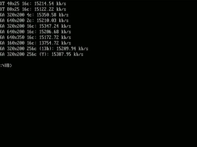

Reply 7 of 7, by zyzzle
Thanks once again for writing the program, and I just downloaded 0.0.4 and it has lots of good additional options! I'm testing it on many DOS system video cards (with and without mtrr's enabled), and so far it has been stable, bug-free and very useful as a benchmark.
