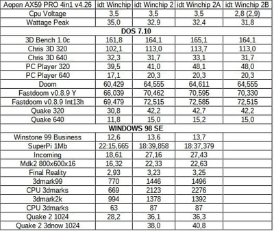

Reply 4 of 26, by Nemo1985
Edit, I can't add any other attachment to the first post, here are the results, finally complete.
51.6 KiB
2155 views
There is not much to add.
The winchip2b is the very same exact copy of the winchip 2. According to the datasheet the 2a is almost the same, but I beg to differ, the results is always higher compared with 2 and 2b (which are the same).
Dos benchmarks are quite rock stable in their values, the biggest difference I noticed is Quake with a 0,1 difference between a run and another.
My winchip2b is somewhat broken it can't run stable at his frequency (200 mhz), but apparently it runs fine with lower settings, overvoltage is no solution, since with 3v the system fail to boot.
The wattage peak is not so different between the v3.52 and v2.8 because probably IDT did on purpose kept the higher voltage to have a better compatiblity with older motherboard.
The winchip 1 is a 486 on steroids, while the 2 is much better, from performance and also wattage point of view.

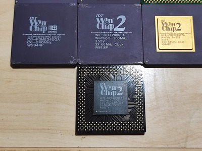

Reply 6 of 26, by Nemo1985
Hey Feipoa, great to see you there.
The cpu with the infamous evergreen adapter is the Winchip2A, i'm talking about this thing (picture courtesy of Tiido): http://www.tmeeco.eu/BitShit/PCschit/NemoStuf … PU/IMG_7842.jpg
Here are the restored pins: http://www.tmeeco.eu/BitShit/PCschit/NemoStuf … PU/IMG_7841.jpg
As for the cpus here is a picture:
1.55 MiB
2062 views
As for performance, my round up is more limited than yours, but yes I agree, on integers the winchip was the slowest one, while the winchip2 was a bit faster, they didn't do much progress anyway.
On my tests in quake 2, amd k6 and k6-2 had 0,8 fps difference, while the k6-2 cxt increased the value of 2,4 fps compared to the k6-2 (my tests were done at 200 mhz 66x3, since a direct comparison at 100 was not possible). Any winchip2 cpu was anyway slower than vanilla k6.

Reply 8 of 26, by feipoa
Interesting. I have a Winchip 2A which looks like yours, except my pins were perfectly intact. Do we know the purpose of this hack job? Was it just to limit multiplier options?
Reply 9 of 26, by Nemo1985
feipoa wrote on 2022-03-11, 09:55:
I suspected it was done to lock the cpu multiplier, but i'm not so sure anymore.
The other 3 missing pin were the: AJ23 AK22 AL21, if i'm not wrong, I identified them just watching the pictures so the eye could trick me.

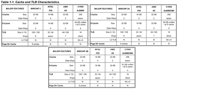

About the cache, there is no difference between the various winchip 2 models.
It can be seen from the test I did and even better on the official documents I posted on the first post (page 11 of every document).
They all have 32kb for instructions and 32kb for data.
80.48 KiB
1920 views
That also explain why people think the performance difference from 2 to 2a I got was inside the margin of error, there is no proof according to the datasheets of any architectural difference between 2 and 2a or 2b (other than the lowered voltage of 2b, probably intended to be used mainly on ss7 machines that may not like the old 3.52 voltage).
I agree according to the datasheets they indeed doubled the l1 cache in winchip3, but since it never made to the public, unlucky we will have no chance to test it.

I agree with Anonymous Coward, that despite they lowered the voltage the power consumption was almost the same of 2\2a.
