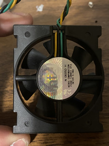

I recently bought a pair of celeron coolers and they work pretty good for my dual socket 7 build but I’ve been annoyed that they are so noisy.
I have a noctuna adapter for making the fans quieter.
928.12 KiB
354 views

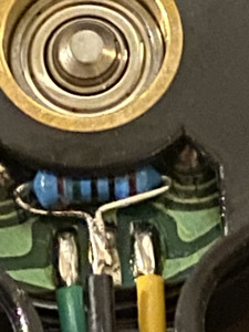

So I got out my volt meter and checked to see what was going on in there, turns out there is a 150 ohm resistor in line with the middle pin. So why not get a resistor and hide it inside the fan it’s self?

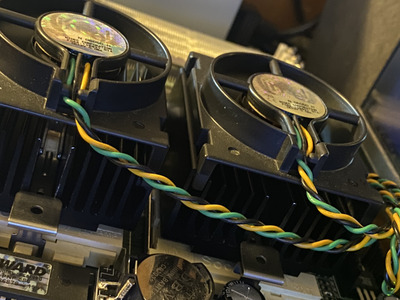

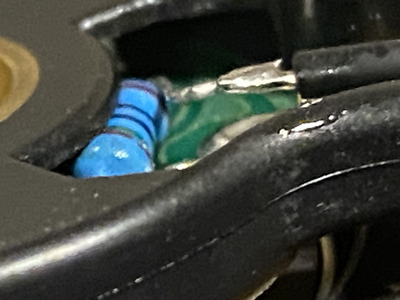

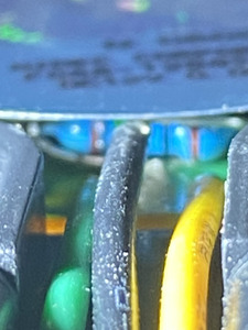

I’m very pleased with the result. Much quieter.
The only thing I think I still need to do is get some sort of black epoxy or some kinda glue that’s black and runny to pour over the wires to immobilize them.one tug and I may have a short…

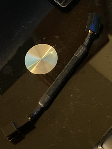

Pic 6

Just for fun, I tested the next best Arctic Freezer Pro here.
That thing draws 0.08 Ampere.
By the sacred laws of Georg Simon, that would correspond with 150 Ohm, were it an ohmic load, which it is not.
But exact science apart, yes, a 150 Ohm resistor in line should cut that in half. Both of them then runinng a t whopping 0.48 Watts.
So, most resistors at hand should take that without complaint.
Funny that Noctua made a busines of that cheap makeshift solution. Applied that to several fans in the 90 yet it felt like a cheat even then. Bit of shrink tubing usually made it look neat enough.
