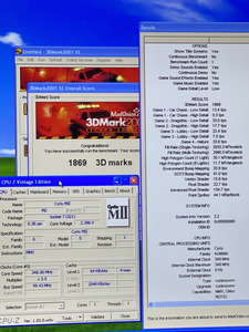

Reply 6 of 98, by Sphere478
Re: Cyrix 400gp multiplier settings
Cheat sheet^ btw

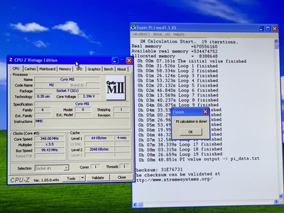

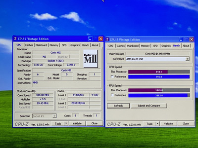

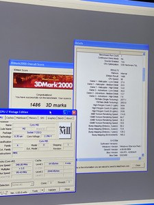

About to do a run on my 400gp
Freeway design ultra mobo
Radeon 9800 pro
Audigy 2 zs
Looks like 4x100 is a no go at 2.2v
3.5x100 it is!
Annnnnd crash…
2.3v…
Crash
2.4v….
Images: 3dmark 2001, followed by 2000, followed by cpu-z, followed by super pi 1m
    1.59 MiB
    2048 views
    1.82 MiB
    2060 views
    1.98 MiB
    2061 views
    1.87 MiB
    2062 views

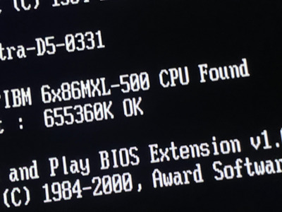

!!!!!All bow before the 500GP!!!!!
(I think the bios stops at 500gp 🤣)

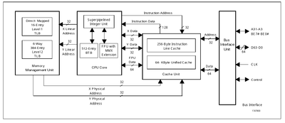

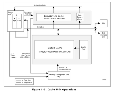

Reply 15 of 98, by 0xCats
Just adding this here
The Cyrix M2 block diagrams, as well as the Cyrix M2 databooks,which can be a bit quirky to find.
54.94 KiB
1907 views
61.73 KiB
1907 views

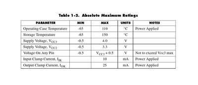

Also the 433GP max ratings:
Vcc3 = IO Voltage
Vcc2 = Vcore (this is for a 2.2V chip) (The NSC node used is just godawful with clock scaling also)
65.93 KiB
1900 views

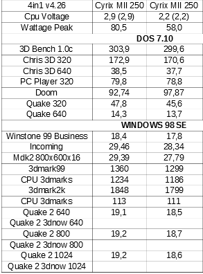

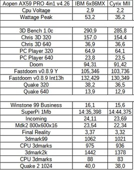

Reply 19 of 98, by Nemo1985
Probably, still the higher v2.9 frequency is 250 mhz (little to none overclocking chance), while the v2.2 is 285 (or 300 for the almost impossible to find 433gp).
That's the performance difference at 250mhz clock:
17.77 KiB
1836 views
The configuration was slightly different compared to the 200 mhz, but somewhat comparable.
At 200 mhz the difference (quake 320 resolution) was 1,7 fps, while at 250 mhz it was 2,2!
So apparently going up with clock increase the performance gap.
