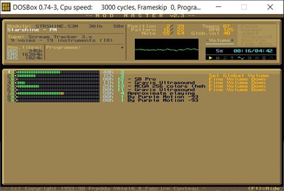

Reply 11 of 117, by FreddyV
dr.zeissler wrote on 2022-04-05, 08:08:
Don't get me wrong, I like MOD-Master, but I prefer glx212 because of the nice-interface and lovely gfx.
Hi,
It is a question of taste.
On GLX, .XM Does not work, there are lot of replay bug, the sound quality is reduced due to the way it mix, the configuration need to be done in the command line, the file selector is basic, no support for adlib, CMS, Tandy...
Need a patch to support CGA, No Monochrome text support.
For the graphic, it add a spectrum analyzer. 😀
Just tried ALTOFLYT.MOD, there are wrong notes all the time 😀
2nd reality, Wrong notes in the portamento
It does not play DOPE.MOD at all (Memory problem I suppose)
Anyway, I know that visually, the interface is not that good, that is why we did Mod Master 2.3 (In 1997)
But it require VGA, that is why I used the Mod Master 2.2 interface
download/file.php?mode=view&id=134424
