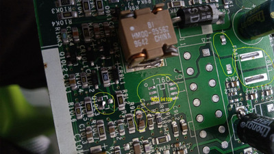

Hello everyone.
Just got myself a intel VS440FX socket 8 motherboard... with a pentium pro 180mhz.. I'm super excited.
Got it from a local scrap yard..
When close inspected, its missing some components.. my world just colapsed.. damm.
i've figured out thar that the IC ists a NDS9410A power relutation transisor.
But need help with the rest.
Nedd to identify what's the L8L1 , FB8L1, C9L1, Q10L3.

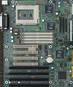

    A GOOD BOARD EXAMPLE

Reply 6 of 15, by snufkin
Not much help, but from the photo:
L8L1 : HM00-94885A This'll be an inductor of some sort, but can't find a datasheet for it, so it'll need to measured or guessed
FB8L1 : unmarked as far as I can see, a ferrite bead of some value, but again will need to be measured or guessed
C9L1 : ceramic capacitor of some value. If you can work out where each side goes then you might be able to work out what the voltage rating is.
Q10L3 : SOT23 package with what looks like 2X marking, which according to this http://www.marsport.org.uk/smd/mainframe.htm is a SOT23 2N4401
NPN transistor: https://www.mouser.com/datasheet/2/149/MMBT4401-889780.pdf

Reply 8 of 15, by snufkin
snufkin wrote on 2022-04-04, 21:01:
Not much help, but from the photo: L8L1 : HM00-94885A This'll be an inductor of some sort, but can't find a datasheet for it, so […]
Was just thinking a bit about this, and obviously it'll be better if you can get actual measurements of what the parts are, and also to check what bits of the board this supply is powering so you know what's at risk, but if you're interested in guesses:
FB8L1 : looks to be about 9mm x 4mm
https://www.mouser.co.uk/ProductDetail/Laird- … DWF%2FH1Q%3D%3D
page 28 here: https://www.mouser.co.uk/datasheet/2/987/Lair … and-1947796.pdf
Mouser say it's 8.5mm x 3.1mm, the datasheet says 8.5mm x 4.5mm. So it should fit. Max current 10A, which sounds reasonable.
C9L1 : case size might be imperial 1206/metric 3216 and I'm going to guess it should be around 10uF (not decoupling, not bulk, but probably not part of a clever analogue timing circuit) and electrolytics nearby are rated at 25V so maybe best to use a 25V part here as well.
But maybe better to measure the capacitance of the nearby C9M7 that you still have on your board.
Q10L3 : There are a bunch of MMBT4401 types here: https://www.mouser.co.uk/c/semiconductors/dis … 20case=SOT-23-3
Although some are only 100mA collector current rated, so you may want to select the 600mA ones to be on the safer side, and higher power dissipation is probably also good.
L8L1 : probably the most important one to get right, and the least likely to get right. Looks to be around 7.5mm square.
Mayyyybe something like this https://www.mouser.co.uk/ProductDetail/Sumida … Wyx2rA5vg%3D%3D 1.2uH, 15A, 6.7mOhm. Pads look like they'll make contact.
A lot of guesses there, so not very safe. Might be fun. If you do try then you'll want an oscilloscope to check how much ripple there in on the supply.

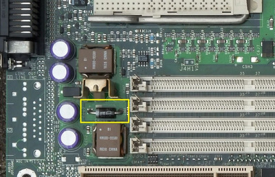

Reply 11 of 15, by Horun
My opinion only: there is a reason those parts were removed w/o damaging any other parts. Best guess is the board is dead and those parts were "donor" parts for another similar board.
Sorry if that is bad news but those parts were 'surgically' removed and not broken off by bad handling. Replacing them probably will not get the board working but never know.... just my opinion
Reply 12 of 15, by luckybob
there's plenty of damage, those parts were ripped off somehow.
that long black part, is a diode, not a bead.
I should have one of these boards, I'll see if I can find it tomorrow.
Reply 13 of 15, by snufkin
Yeah, you can see the damage and some solder rework on the big inductor L9L1, and half of C9L1 is still on the board, plus there's some other rework been done with surface mount capacitor C8M1 being replaced with a through-hole. Given the amount of damaged components I'm surprised at how little damage there seems to be on the PCB. I think there's a fair chance there may be more wrong with the board.
PIcking up on Pentiumspeed's point, I noticed that the replaced capacitor is a Chongx, who don't have a particularly good reputation, e.g.: https://www.eevblog.com/forum/projects/beware … ngx-capacitors/
I went with ferrite bead for my guess for a couple of reasons. Firstly, I don't think I've ever seen a diode that doesn't have some sort of case marking for polarity, and I can't see even a faint one on that component in bofh's photos. Other diodes on the board have one end marked with a grey stripe. Secondly, the silkscreen marking for it is FB, and other diodes on the board are designated CR (current rectifier?). If you look over by the PS/2 port there are a bunch of unpolarised components where you'd expect to see some ferrite beads and the silkscreen has them as FB.
OTOH, it seems an odd place to have a ferrite and it's not completely unknown for silkscreen to have mistakes. If luckybob can check the components on an actual board then that's far better than random guessing on my part.

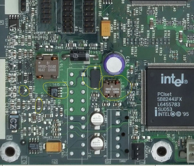

Reply 14 of 15, by nuno14272
The board was taken from a scrap yard. so the damage is only in this zone and because they have put a case on top of this board... and the corner or the case ripped out this 4 or 5 conponentes...
The only thing i did, so far, was exchange the aluminium eletrolitic capacitors with new ones.. (and used apparently a bad brand - they where 25V original...used 100V.. so i think i'm ok...🤣)...
Yes the board as other ferrite beds near the rear connectors.. not this big.. but unpolarised.. .
The marking + being for the other diode next to it doesn't seens right because the black list is the -... i've always seens the silkscreens on other board with FB being ferrites but this board is making me second thoughts..
WAIT... JUST WAIT
in this foto.. the diode as the +.. is the + for the diode after all ?????? man...

Reply 15 of 15, by nuno14272
luckybob wrote on 2022-04-07, 05:11:
I there.. digging out this thread..
i think is time to try out this board.. I've ordered some parts from portuguese icshop mauser.pt, but..
i think luckybob as pointed to something right.. a simple ferrite bead in that place one the board does make sense ?
