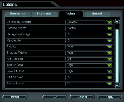

One of the things Supreme Commander was very notable for when it launched in 2007, was the ability to use two monitors - typically you'd have a "primary" monitor you did most of the playing on, and you'd keep a zoomed-out map up on the 2nd monitor, but you could zoom in and do stuff on it also if needed.
This was done via "Fullscreen" mode, configured in the game's options. It allowed you to select what resolutions you wanted both for the primary and secondary display. It did not have any mechanism for selecting *which* secondary display you wanted to use.
On my modern Windows 10 machine, Fullscreen support is completely broken without dgVoodoo2. With dgVoodoo2, Fullscreen on the Primary display appears to work fine, but things break if the game is configured to use the secondary display. The game does appear to be correctly enumerating the secondary display (The list of resolutions it gives me is correct to the number 2 monitor on the system). The secondary display never initializes or shows up, and the Primary display ends up being resized to something like 640x480 or 800x600, despite being configured for 2560x1600.

Regarding the missing visual effects, perhaps my in-game graphics settings have something to do with it?

The game works, though I once had it fail to actually go fullscreen - the fullscreen was "behind" my desktop and the secondary display did not appear. I had to alt-tab out and click Supreme Commander on the taskbar, which showed two "windows" for the program, and I then had to click the window for the Secondary display, then the game came up and appeared correctly.
Rendering appears to be correct - no missing gate-in visual.
But the Secondary still looks off. Maybe the original game looked like this, but I don't remember it doing so.
Debug output (redacted)
Screenshot of dgVoodoo - note the blurry text on the ACU name on the Secondary display
Screenshot of Forged Alliance in Borderless Window mode - note the sharp text on the Secondary display
