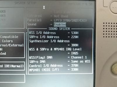

Imho all you need is one line in autoexec.bat...
SET BLASTER=A220 I5 D1 T4
...and adequate settings in BIOS, see attachement 😀 It's from Libretto 50CT, but I quess 60CT is pretty much the same.

Thanks for the advice! I checked my BIOS and the only difference was SBPro DMA channel, I changed it to be the same setting as yours, added the SET BLASTER line to my autoexec.bat, but no go, still no sound 🙁
I even tried manually adding the variable to my DOS ENV to no avail.

My system does NOT have a CMOS battery (had to remove due to leakage) and I was noticing that my SBPro DMA setting was constantly reverting back to Channel 0 despite changing it to "Same as WSS". Even when I would leave the laptop plugged into AC, change the setting and reboot (no F1 error), still reverts...
Well now miraculously it seems to be defaulting to "Same as WSS", even when I remove the system battery for battery swap (I have multiple batteries for the laptop).
I tried running setupsa.exe and i got to see that all the sound levels checked out in the program (nothing of relevance was muted), so I exited and to my amazement, Doom2 produced sound!!
I will do some more testing, but I think it was that pesky BIOS setting constantly reverting even after I would change it.

WSS and SB Pro settings should not conflict. I used to have a similar Toshiba and I remember having to go through every permutation of those settings before finally finding one that worked. Make sure your BLASTER environment variable always matches what you selected in the BIOS.
