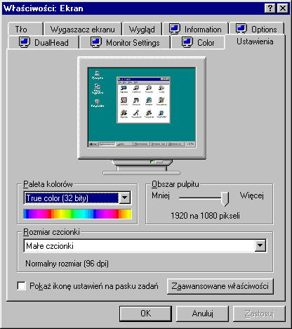

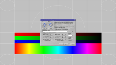

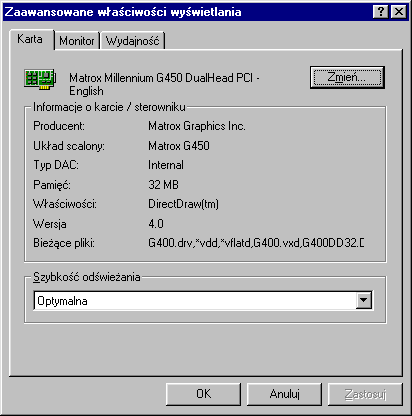

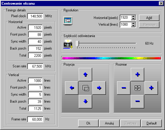

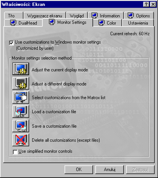

I have the Matrox Millennium Dualhead DVI + VGA card and works well in Win95 with the 1920x1080 monitor but only via the VGA - VGA cable with a 6.23 driver but I had to manually adjust the Monitor Settings (PowerStrip helped me):

I changed the cable and try via DVI-HDMI cable with the w9x_682.exe (Matrox Millennium G450 DualHead DVI PCI) driver but the monitor does not want to turn on - it only works with the Standard PCI Win95 driver.
P.S. I have a Remote Administrator running and it can be set up in it up to 1920x1080 but the monitor does not react ???
I also tried the 682 Digital First Millennium G450 32D driver but it doesn't help either 🙁
