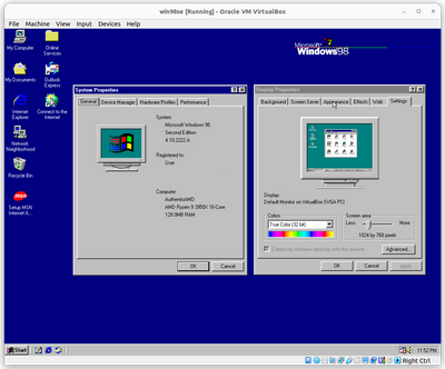

Ryzen 9 3950X (VirtualBox, janih)

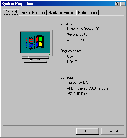

Reply 1 of 66, by Stretch
Thanks for this patch. I patched the win98 folder from ISO with patcher9x and installed Windows 98SE in VMware Workstation 16.2.3 on the AMD Ryzen 9 3900.
Windows 98SE runs much faster after the VMware Tools are installed. Stability so far is fine. I have just installed the hotfixes from Security9_enu_15.iso

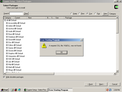

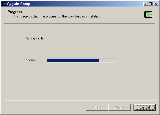

Reply 16 of 66, by Kahenraz
I'm having a problem with running Cygwin 1.5.25's setup where it keeps locking up when "Parsing ini file". This doesn't happen on actual hardware on a fast Core 2 Duo, but it does when I try to run it in a VMware virtual machine on my Ryzen 1800X. I tried this patch, but there was no improvement.
I don't know what the problem is, but it's reproducible. I found that if I kept resetting the system and re-running setup, it would VERY RARELY get past this problem and allow me to continue. It feels like some kind of timing issue, but may also be related to my Ryzen CPU; I can't know for sure. But I can confirm that I have never had this problem in either Windows 98 or ME on actual hardware with a fast CPU. One time I was able to push it past the problem, I got a weird dialog about a missing DLL, but the file name was corrupted.
Do you know if this is related?

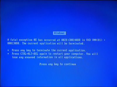

Reply 17 of 66, by Kahenraz
I encountered this blue screen after installing this patch on one of my retro desktops. It mentions VMM, so I wanted to mention it, in case it's related. It occurred at random but then would trigger whenever I tried to interact with things on the desktop, like running a program or opening a shortcut. I had to reboot to make things sane again.

Reply 18 of 66, by JH64
Hello Kahenraz,
About Cygwin: It’s look more like problem with file system/disk driver/DMA (esdi_506.pdr?), but why only on Ryzen? (VirtualBox + Intel is without this problem) – I have access to Ryzen 1600, so I’ll try to simulate it.
About BSOD: I have never tested on bare metal hardware, so it’s probably bug in patch, I’m sorry for it 🙁. Patcher creates file backup (C:\WINDOWS\SYSTEM\VMM32.BAK -> VMM32.VXD or C:\WINDOWS\SYSTEM\VMM32\VMM.BAK -> VMM.VXD) so if you copy/rename back you’ll recover system without reinstall.
I have an idea where the bug is, so tomorrow I’ll try install win98 on some old PC, then apply patch and I will try to find a solution. Originally TLB bug fix doesn’t make sense on an old computer but with combination with CPU speed patch it is use-case too.
Could you please post your CPU name in your retro computer? In case that is not bug in my code I’ll probably need some CPU blacklist to prevent install VMM patch on them.
Reply 19 of 66, by Kahenraz
It's a Core 2 Duo e6700. I've been troubleshooting out of memory issues and wanted to see if this patch would make a difference.
