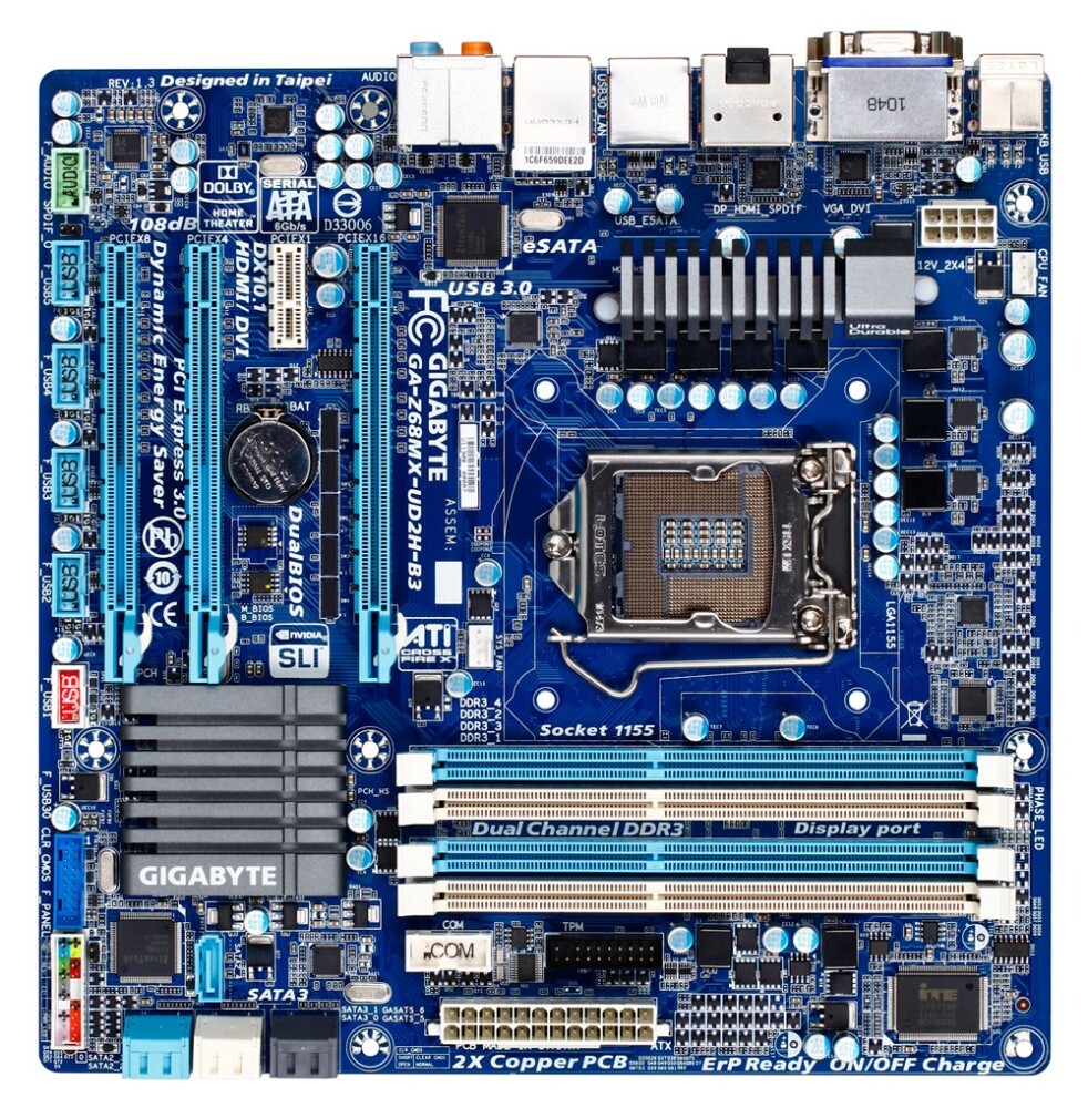

Reply 14 of 39, by gerwin
pentiumspeed wrote on 2022-09-24, 22:53:
Intel 6 series chipset what is yours? 6 series is made for Sandy Bridge and Sandy Bridge is PCI-e 2.0 only also if the mother board is low end, you will only have x8 if other items is using other half of PCI-e x8. To get full use of PCI-e 3.0 x16 with HD7750, you need a inte 7 series and a Ivy Bridge processor.
Cheers,
It is a GA-Z68MX-UD2H-B3 rev1.3 Motherboard.
Notice that it actually says "PCI Express 3.0" Below the third PCI-E slot. Attached the GPU-Z screenshots of both mentioned cards when not idle.
I am not worried that 8x lanes PCI-E is much of a bottleneck.
gerwin wrote on 2022-09-20, 21:26:
3) Driver (20)13.1 Both issues solved. I actually have zero compatibility problems with this driver so far. Almost too good to be true...
The game Il-2 Forgotten Battles actually did show OpenGL water rendering problems when FSAA was forced. So I placed atioglxx.dll v12.6 in the game's root and that fixed it.
Besides that, I noticed atioglxx.dll v13.1 and v 14.4 have the same file size of 18.964.480 bytes. Which suggests the OpenGL driver got no changes in that period.
