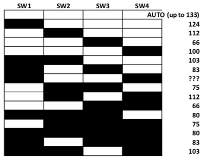

Reply 3 of 12, by Babasha
I checked it with Celeron 900MHz (100MHz), 1.75V SL5MQ. The positions of the switches that set the FSB and got just such a table.

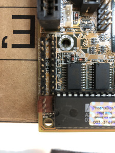

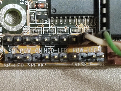

Reply 4 of 12, by Babasha

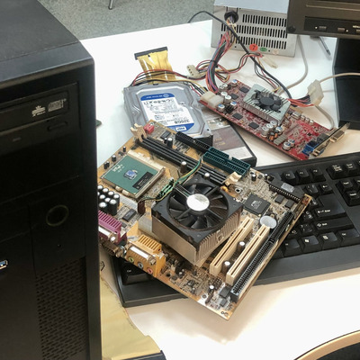

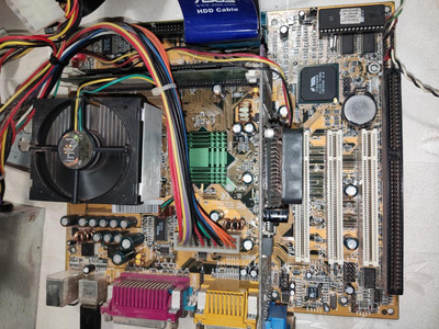

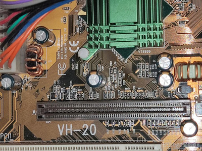

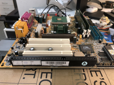

Some hi-res photos of mobo, signal pins and external USB connector.
Continue to test it with PIII 1GHz, 1.75V Coppermine CPU.

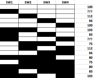

Reply 6 of 12, by Babasha
Today I recheck it with P3 1GHz (133x7.5) and found
All off - is a Auto mode
SW1 - on, SW2-SW4 - off - is 124MHz
SW1 - on, SW2-3 - off, SW4 - on - don’t start???
Ate there any ideas?
Reply 7 of 12, by snufkin
Babasha wrote on 2022-07-06, 18:09:
Today I recheck it with P3 1GHz (133x7.5) and found All off - is a Auto mode SW1 - on, SW2-SW4 - off - is 124MHz SW1 - on, SW2 […]
Maybe SW4 is connected then, to the FS3 in that datasheet (page 12). In that table a '0' is 'on' and '1' is 'off', and FS0=SW1, FS1=SW2, FS2=SW3 FS3=SW4.
So SW4..1=off,off,off,on is the same as FS3..0=1110, which from the table gives FSB@124MHz, PCI@31MHz
SW4..1=on,off,off,on is the same as FS3..0=0110, which should be FSB@68MHz, PCI@34MHz.
Maybe the FSB clock is too slow for the P3? If you want to clock it at 133MHz then try setting SW4..1 to all on.

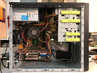

Reply 9 of 12, by Babasha
My test rig 😀
Reply 11 of 12, by Babasha
Switches test with PIII 1GHz Coppermine
