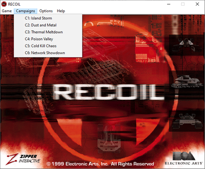

Hello,
When you start Recoil with the parameter /campaigns you will get an extra selection menu in the main window.

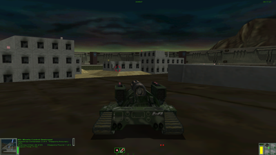

If you want to use my patcher, do a backup of the original exe file, place my patcher in the same folder as Recoil.exe, start the patch and type in the desired resolution.
Change the resolution to 1024x768 in the starter-menu for your custom res to load.
The HUD background image does not get scaled and causes artifacts, just press F6 and F5 to adjust the layout, most people play it without it anyway.
