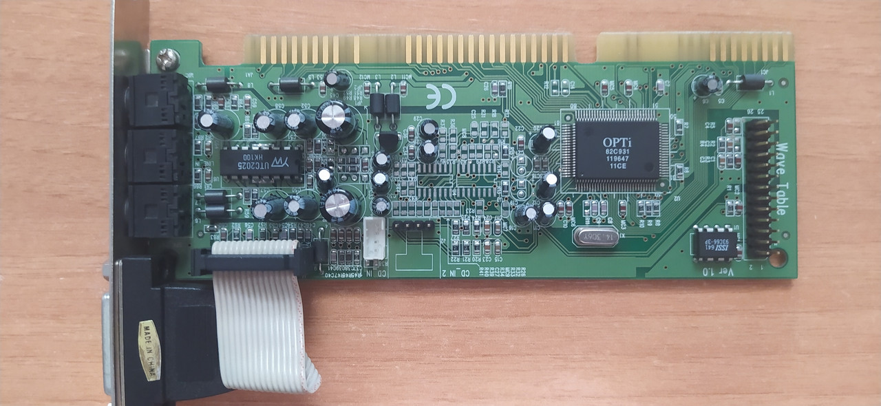

Reply 6 of 14, by harris286
I had this old ISA card.
He thought the Sound Blaster LIVE was better.
How does it sound? Is it as good as the Sound Blaster?
thank you all for helping
Reply 7 of 14, by mkarcher
If your primary requirement is sound quality (in compatible games), the SB Live is clearly the better card. If you are interested in EAX or DirectSound accelleration of 3D sound, if you are interested in high-quality MIDI music, the SB Live is your only option.
If your primary requirement is compatibility with older DOS games, the ultra-cheap bottom-of-the-barrel OPTi based card is likely better. The OPTi card does not provide SB16 compatibility, just SB Pro (and "Windows Sound System", a 16-bit sound standard supported by everyone except Creative Labs). So for the handful of games that support 16-bit sound on SB16, but do not support WSS, the SB Live might be superior. Be aware that the OPTi card will not work unless you run an initialization program in AUTOEXEC.BAT. That program doesn't occupy any memory permanently, it just makes the card ready for operation in the required mode at the addresses, interrupt and DMA channel you choose and exits.
Reply 8 of 14, by dionb
That OPTi 931-based card looks like a really low-end card. It will work better in DOS, but will not sound better (except with OPL3 FM synthesis - although not much better).
Once again, it depends on what you want to be playing exactly. How about telling us which DOS games you are most interested in?

If it a pure dos rig I'd try the Opti card at least as a starter card. Truth is no 1 single isa card is best at everything, at least this will give you something while you work out what's important for you, ie OPL, SB16 compatibility, etc
