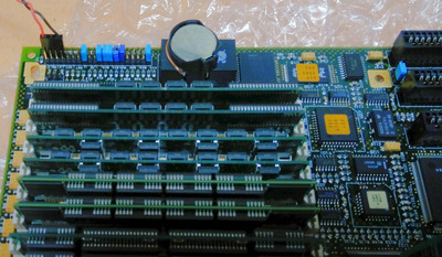

The DS12887 was dead all the time as I bought the board - no wonder it was ~25 years old. I tried to replace it with DS1287 with OK batt but no change. Without RTC it doesn't boot neither to Debug Monitor (hangs soon at POST code 00).

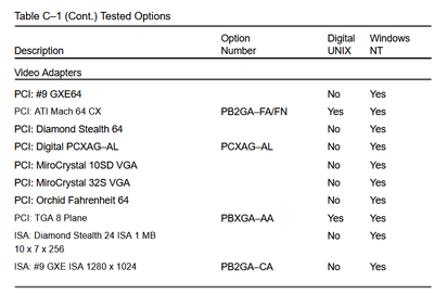

What VGA cards are you using? The BIOS emulation is a bit picky, I run my Alphas with Permedia 2 based cards which tend to work with everything (AlphaBIOS, NT and Linux).
Reply 4 of 14, by dionb
ATi cards were also supposed to be supported, sort of. One of my to-do projects is an AXPpci 33 board. I received it with an ATi Mach64 which was supposed to work. Reading up on it, it turns out to be more complex: it does show output in ARC (BIOS emulation) and MILO (Linux loader), but not the SRM console. To get that, you need to monitor the serial port.
For what it's worth, this is the official list of supported cards on the AXPpci33:
34.36 KiB

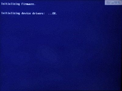

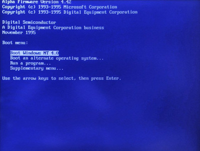

Well, I repaired the Dallas RTC via common grinding method (Vbat was too low ~0,3V) and thankfully it booted NT FW. So the FW is not compatible with neither DS1287 nor DS12C887A it seems only original DS12887 working. I can set date&time in Debug Monitor and it no longer complains about "Invalid NVRAM: Bad date Feb 4 11:33:30 19166".
The NT FW now boots quite fast, cca 35s from power up to first blue screen, BIOS emulation banner is visible just for a second. The final POST code is 00h. But I have a problem that now NT FW complains about bad date&time and boot config. Even if I set new date&time (tried 2022 and 1992 for case of Y2K bug) and restart it still complains but the date&time is set properly as seen in System info screen. Also tried to load default settings and didn't change...

NT FW:

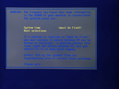

At least I downloaded the latest ARC and SRM firmwares for PC64. It seems that AlphaBIOS FW never existed for this old board but don't mind. Also there should be some MILO image for booting Linux but I found only some MILO floppy images instead ROM image to flash. So I put ARC and SRM on a floppy and performed FW update (I didn't have SRM installed before, just NT FW). It flashed without any problem and I can select both FWs. But the problem with SYSTEM TIME - must be fixed issue still persist. I tried again go back in time and found that any date after 1.1.2021 fails. This is quite weird break value, I would mostly expect well known Y2K problem. But it is not the RTC HW limitation! When I set 31.12.2020 23:59:50 I can watch successful rollover to 1.1.2021 0:00 in console so it seems to me like they put intentionally a timebomb inside the FW - this calls to be cracked but I don't have knowledges about ROM image format and how it's protected by some CRC, etc...
So I just set year 2012 and now I'm able to continue to WinNT install menu finally. I have to hook up some IDE HDD and CDROM drive and look for NT4 CDROM, I have it somewhere...
