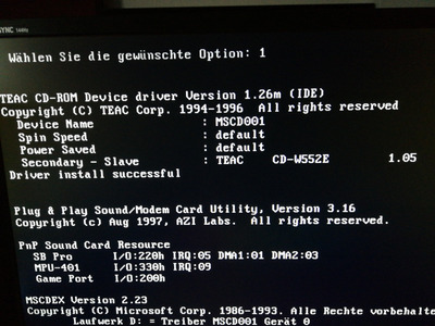

greetings to the community first. This is my first post. My question would be, since i started some retro computing too.
Does anybody know how to adjust the spin speed of the TEAC W552E CD-ROM drive via autoexec.bat ?
It seems like MSCDEX on it´s own is not capable of ?
Operation System: MS-DOS 6.22
Motherboard: Elpina L621 (if anyone could provide a manual it would be fantastic, this manufacturer seems like to be a ghost on google)
CPU: Pentium MMX 200 MHz
RAM: 128 MB
Thanks for any suggestions in advance.
Grim82

Reply 4 of 7, by Grim82
Hi Joseph_Joestar,
thanks for the link. I luckily had the teac_cdi.sys driver in my config.sys file.
I added the /S:4 command. Now it boots up and is telling me:
Spin Speed: Auto*4
When i change it to /S:1:
Spin Speed: Fixed*1
But still, it behaves like CDBeQuiet. If no CD is inserted, it will throttle up to it´s maximum 52x speed.
If CD is inserted and the system is rebooted the drive will recognise the /S:4 option and reduce the output to 4x CD-ROM speed.
