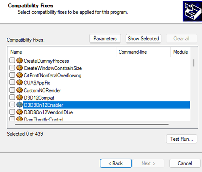

Anyways I found the shim...
Update: History Channel CW makes the shim not display MSI Afterburner statistics, while Burnout Paradise shows it to be using D3D9 still. What's the best way to log what driver is being used?

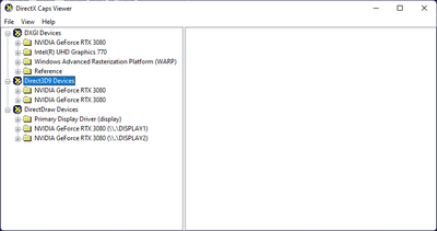

D3D9on12 takes the place that a regular vendor specific D3D9 driver otherwise would take if the device drivers lacks such a native driver. Tools that would report the capabilities of the native driver/hardware instead does not find a D3D9 device to report on, and will turn up empty.
Note here in DirectX Caps Viewer how the 12900K's Intel UHD Graphics 770 appears as an available DXGI device, but is missing a Direct3D9 device:

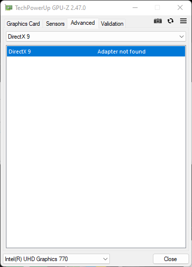

And here in GPU-Z when we're expressively looking at the Intel UHD Graphics 770's DirectX 9 feature set the tool reports that the adapter was not found:

Of course most of this translation/mapping is completely transparent to the games, and they'll continue to issue D3D9 API calls as always while the D3D9on12 driver in the back maps the calls to D3D12 API calls that is then sent to the native D3D12 driver.
Not sure how relevant it is, but apparently nowadays D3D9on12 handles all D3D9 versions before 10, including DirectDraw. Just learned that the other day from the DirectX team on their Discord server.
