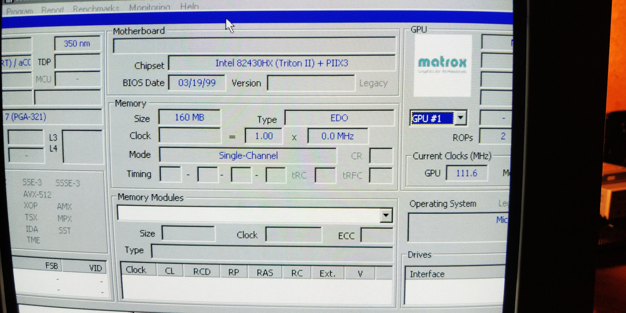

Is it normal that CPU-Z says I have a Matrox G400 AGP video card?
I downloaded VERSION 1.03 VINTAGE VERSION from the official website
I also have an old version 1.57 for windows 98 from 2011. BUT this doesn't see any graphics card installed.

NarakuITA wrote on 2022-09-01, 15:42:
Ok, there are, but I didn't understand what I should change ... https://i.postimg.cc/5tB5hh80/IMG-20220901-173846.jpg I go to "P […]
I go to "Properties" and then "Resources". I don't see any conflicts.
Do I have to manually change the settings, "input / output range" and "memory range"?
Leave the resources alone. Change the driver for the S3 card. Click "Change Driver" on the "General" tab. Update the driver manually to Standard VGA Adapter. Reboot, then disable in Device Manager. Reboot once more.
What happens then?
Reply 14 of 44, by Meatball
NarakuITA wrote on 2022-09-01, 16:08:
The card is based on the same architecture as the G400 with some changes.
However, try using HWINFO:
https://www.hwinfo.com/
Or try Powerstrip:
https://entechtaiwan.com/util/ps.shtm

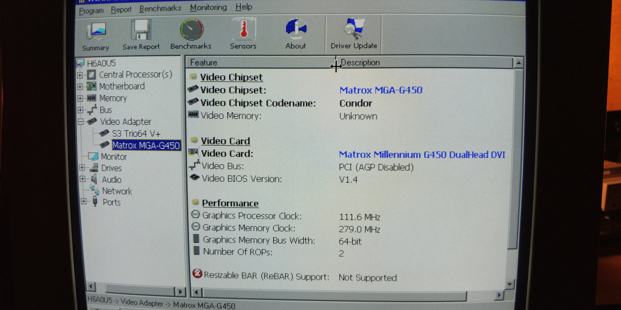

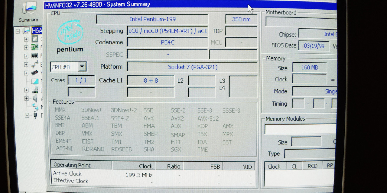

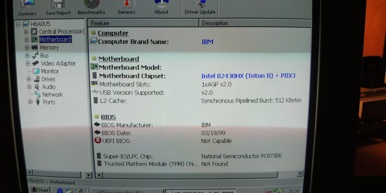

Reply 15 of 44, by NarakuITA
I tried HWINFO this is what it finds:
PowerStrip instead, when I start it from error:
The primary graphics adapter is not configured correctly. To avoid problems, the execution of the program will be terminated.
If instead of canceling I do ok, it appears:
New hardware detected - a new bus1 graphics adapter, device 0, function 0 has been detected and the current settings have been registered as default for the current adapter.
IMPORTANT! If the current settings are not the default settings for the adapter, Cancel the operation to restore the default hardware settings, then load the program again.
What do I do, continue or cancel?

Reply 17 of 44, by Meatball
NarakuITA wrote on 2022-09-01, 19:42:
I tried to continue, but the program closes, it doesn't work.
Powerstrip it seems, doesn't like the 2 adapters installed at once when they are conflicting with each other. But you need don't Powerstrip now since HWINFO is reporting the G450.
