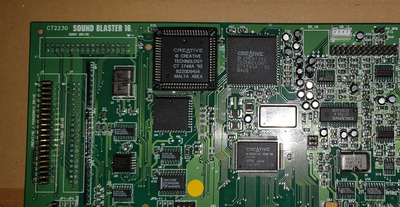

Howdy anyone that can help , I just recently got a CSP chip and installed it in my sound blaster 16 CT2230 , removed the IFSD and APSD jumpers as required but I'm getting a low level driver error after installing the drivers and attempting to use the utilities, it seems to detect the chip but the qsound utility doesn't want to use the chip , any ideas?
1.38 MiB
1010 views
Reply 1 of 14, by Jo22
Hi there! It's been years ago, but I vaguely remember that not all Creative SB16 drivers supported the ASP.
Maybe the version you use is simply too old or too new (dropped support for it)?
If the diagnose utility finds the chip, things are likely fine hardware-wise.
Reply 2 of 14, by AppleSauce
Jo22 wrote on 2022-10-13, 08:40:
Yeah the Diagnose utility seems to have found the chip , do you happen to know what the latest driver that supports the csp chip is?

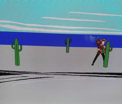

Reply 3 of 14, by AppleSauce
Okay I ended up using an older driver and that did the trick , but how does the qalign utility work?

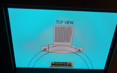

Reply 4 of 14, by AppleSauce
Well the Demo works as well.
As far as I can tell its being detected in TFX but I cant tell much of a difference sound wise , so I'm not sure if its working or not.

Reply 8 of 14, by AppleSauce
Cloudschatze wrote on 2022-10-15, 02:20:
I have a post in the following thread that may provide some direction: […]
AppleSauce wrote on 2022-10-15, 01:47:
I still am pretty determined to get TFX working though.
https://web.archive.org/web/20140905151351/ht … pic,1778.0.html
Specifically, the v1.0 diskette release of TFX needs to be used (although, now may be a good time to revisit that...), and CSP.SYS needs to be loaded.
Believe it or not I already went though different TFX exe's with a hexeditor in order to investigate what made the game tick to find out what's wrong and found that anything after patch 1.0 for the floppy version removed references to qsound so that was something to keep in mind , still thanks for the help I do appreciate it.
It turns out the actual issue was that I had my speakers too far apart , after putting them next to my monitor and comparing the CD and 1.0 floppy version I can hear some panning in the floppy version , its a bit disappointing tbh , nowhere near as fancy as A3D.
I guess I'm not sure what I expected with this being 1993 not to mention the rebadged SGS Thompson chip being implemented by Creative Labs who was known for half assing things.
Still it does make the chip slightly less than useless , I might also give using it for audio decompression in win95 a go.
Although this pc uses a Pentium 233MMX so I'm not sure how much of a boost using the ASP chip would be.
